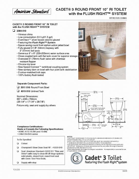

    is it possible to put the 10" rough-in tank (4019.016) onto the round front bowl (3011.016) for a really tight space toilet or does that not work? They aren't sold together as a kit, that I can see. Normally the 10" tank seems to come with the elongated bowl so I think I'd have to buy them separately.
    Yes.
    Those are the exact part numbers for the AS Cadet 3 RF 10" number 2384010 in the catalog. Nominal dimensions 26-1/4" x17-1/4" x28-7/8". See the link for the spec sheet.
    http://www.americanstandard-us.com/A...Sheet_1810.pdf
