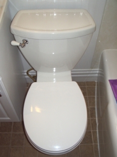

    Now I have some space, and as a homeowner in more ways than one it would appear, I thought I would post some pictures of my race-tuned Cadet 3.
    It all started over 2 years ago when I took a stock 1.6gpf and decided to pimp it up a little.
    First, I fitted a Toto softclose lid to smoothen the ride and a new handle. This pic reminds me of why I chose a Cadet 3 in the first place. Note the tight gap I had to work with between the vanity and the bath. Most toilets (tanks) were too wide.

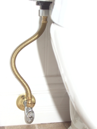

    Next a brass-braided pipe and escutcheon. They don't rust like the cheap silver metal ones will if your bathroom gets damp like mine (from long showers). Plus they are a little bling. Yes, I know I should fit a brass nipple and angle stop too.

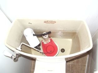

    But of course what really matters is what is under the hood. Out came the stock stuff and in went a Korky Quietfill and a new flapper. These really smooth things up and the Cadet 3 runs really nice with these.

    I like it. Now, I want a new handle on mine, too. That looks nice. Good job.

    I think you need some decals for that high performance race toilet...

    That is GORGEOUS, and I approve!

    So give up the part numbers for the replacements you put in. You've got an elongated bowl, it appears. Which Toto lid did you put on it and how did you know which would fit? Looks like there's a slow-close American Standard lid as well for round fronts 5330.010 is the part number.
    How did the Quietfill improve the flush?

    I have a round bowl and I just put an ordinary Toto softclose lid for round bowls on it. A straight fit. The Toto softclose is a love it or hate it lid. I love it because it closes softly. My wife hates it because it looks too plasticy. And some people find it a funny thing to sit on. The hole in the seat is quite small with steep gradients on the sides (which incidentally I like because you get less waste under the seat if someone misfires).
    The main advantages with the Quietfill over the Fluidmaster stock fill valve are twofold.
    They are both reliable units but:
    1) The Quietfill does fill quieter. I like that.
    2) The float is enclosed in a case. It could not get obstructed as easily as one on a fluidmaster (say by a flapper that went crazy one day or a badly adjusted flapper chain).
    Some say the Quietfill does not close off as harshly so you get less water hammer but I did not notice any difference (I do not get water hammer anywhere in the house anyway).
    And another (weak) advantage might be that the fill tube is more robust on the Quietfill.
    I hope this helps!
    The valve does not improve the flush but it smoothens the fill. The flush is unsurpassed on these things anyway.
    Now the Korky flapper, that makes a big difference to the reliability of the flush...
