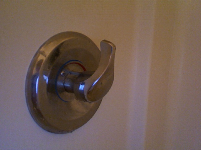

    Everything else is fine, the faucet in my main bathroom, hot water for the washing machine, my other two bathrooms and showers, everything else is fine. I am thinking there is a blockage in the faucet in my main bathroom shower. everyone agree? How hard is it to do this and what other things could it be? I also have a joint hot/cold control, if you get past half way, that's how you get to hot water.

    Why don't you tell us exactly what this shower is doing and what make/model mixer valve you have. Post a picture if unknown.

    That is exactly what I was thinking the problem was.

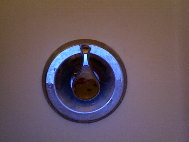

    It is a Moen Faucet, here is a picture of it, I am very new to the whole plumbing thing so terms, what to dos and normal jargon is like speaking another language to me. Any help you can provide would be appreciated.

    It's a Moen Posi-Temp.
    The cartridge needs replacing.
    Call 1-800-BUY-MOEN they will send you one.

    A removal tool will come with the new cartridge along with instructions...
    Currently the stem the handle attaches to is rotated 180 degrees out of position that is why its acting funny.
    Have you called Moen yet? You don't want to bust up the existing cartridge it will make it hard to remove.
    I did call Moen, they said that they will send me a puller tool and gave me instructions on how to clean the existing one to fix it. They agree the cartridge is the problem though. So they are sending me the puller tool free of charge.

    With the handle and adapter off turn the brass stem that the handle attaches to 180 degrees and put the handle back on.
    Alright, I got the pulley thing today, rebuilt the cartridge and installed, the pressure problem is fixed BUT now I have water coming out of the faucet part? Any ideas on what I did wrong? It's a decent amount, not just droplets. I'm worried about whether or not it's leaking into my wall as well. Any quick fixes out there?

    Nevermind, problem is fixed, it was a stupid rubber o-ring.
