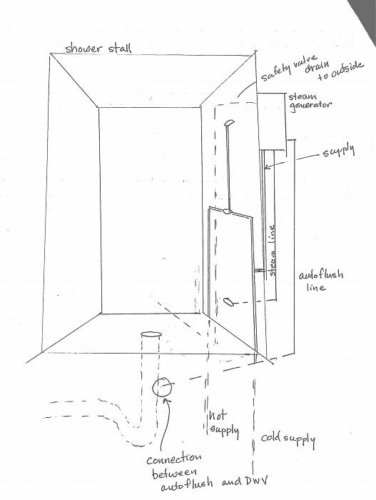

    I recently had a steam shower generator installed. At the rough in inspection, the inspector said that I needed a dual check valve in the line that connects the autoflush drain from the generator, which is gravity fed not pumped, to the DWV. The way the line is plumbed is from the generator with 1/2" copper to the PVC shower drain
    pipe before the shower trap.
    The plumber insists that I don't need a dual check valve, and installed a swing check valve. The plumber also thinks that a dual check valve may cause my steam generator to malfunction. I've called the maker of the steam unit and technical support there was not much help.
    Can somebody please tell me what to do. Who's right - the plumber or the inspector? Can you explain how each of these valves work so that I can weigh in during the next rough-in inspection?

    The dual check has an integral air gap which may be why he wants that particular valve. If we saw how the autoflush is plumbed it might make it more logical. It is spring loaded so it will take a certain amount of pressure to open it.

    Thanks! I've attached my quick sketch of the plumbing I have seen with my own eyes. I know that pipe size and angles are important to plumbers, but this is just a sketch and doesn't represent that stuff. I you need more info about that stuff I can write it.

    Nice sketch!
    As installed you have about 6 feet of head pressure which is about 3 psi
    3 psi should be enough to open both check valves

    You need a dual check with intermediate vent there. The set up presents the possibility of a backflow situation. The inspector is correct and the plumber that says no needs to go back to school.
    9,003
    When we are talking about backflow, I don't think a single swing check is ever an approved solution. I would consult a licensed backflow prevention company if you want better info, because hopefully they have attended "Backflow Univ"

    You could use something like a Watts #7 dual spring check. They have diagrams on their web site. Another option would be to create an air gap. It might be possible to pipe this auto flush line into the shower just below where the steam line enters the shower.
    23,540
    The autoflush MAY operate while there is still steam pressure in the unit, in which case it will be adequate to operate a double check valve. The few I have worked on have the drain going outside into a planter area, because you are NOT supposed to discharge "superhot" water directly into the drain system, and DEFINITELY NOT into an open shower drain where hot water under pressure could splash up and burn the user. But a better way, if it can be done depending on what is behind the wall would be an indirect connection using an air gap, similar to a washing machine drain.
