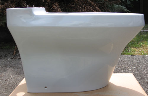

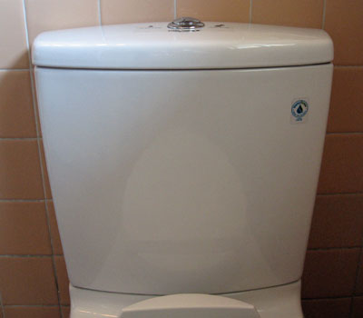

The new Toto Aquia 3, CST464M dual flush toilet product review.
Aquia three, Aquia III
Pictured with the Toto SS204 softclose seat in Cotton White.

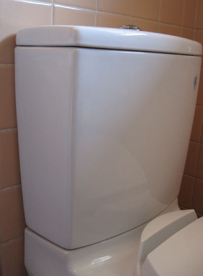

The smaller side of the button is for the small flush, the larger side of the button is for the larger flush.

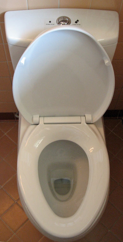

With the seat lid open.

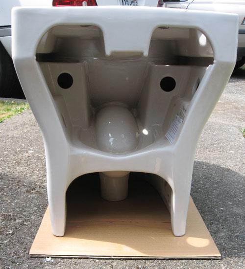

Looking at the back of the bowl. The drain from the bowl fits into an adpapter that comes with the bowl.

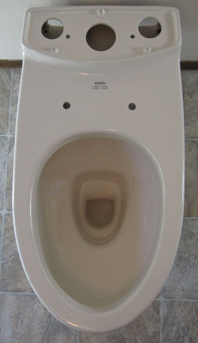

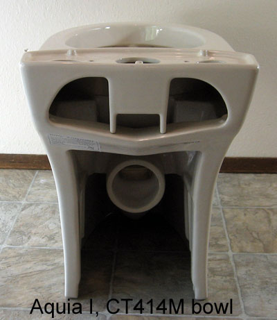

The Aquia I has a MaP rating of 800 grams using the adapter on the left.
The Aquia II and III use the adapter on the right, with a different bowl design with internal trapway.
Back of the Aquia I bowl
Top of the Aquia I bowl
Back of the Aquia III bowl

My wife and I are also looking at the Aquia model with the dual flush buttons. I was originally planning on the Ultramax, as it has a two flush system as well. However, as you need to do a quick flush to get the small one, and you need a long flush for the regular 1.6 gpf, my wife was worried about having to explain this to guests. We are hoping the Aquia should be more intuitive :)
I too am curious how the Aquia II/III perform in the real world. Any word yet Terry?
Also, can you please confirm if there are any technological differences between the Aquia II and the III or not?
From the PDF link above, it looks like the III has a slightly different bowl shape, a larger, more encompassing skirt, and a sleeker tank. The III is a bit taller, but the PDF seems to imply that the II will be getting a height upgrade this fall as well.
3,461
The Ultramax uses either 1.6 or somthing like 2.5 gallons if you hold the handle down.
The Aquia uses 0.9 or 1.6 gallons.

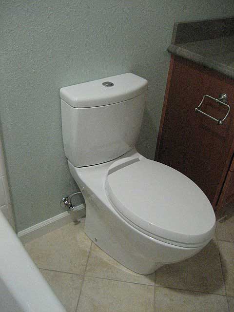

The new Toto Aquia 3, CST464M dual flush toilet set at 11.5" from the wall.
