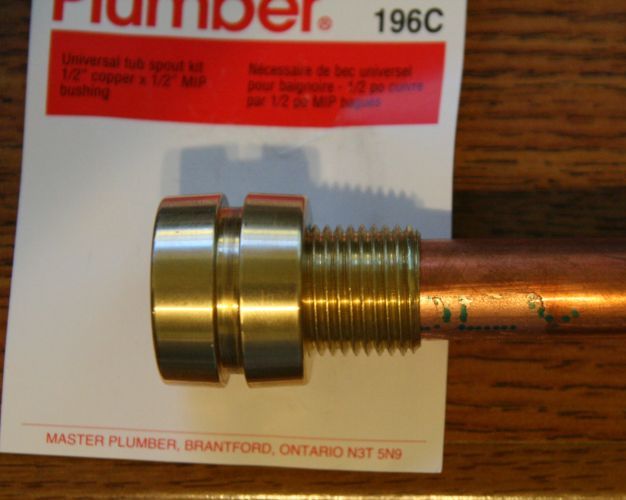

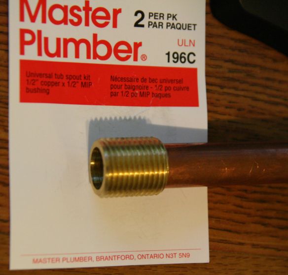

    Hi Guys,
    I'm remodeling my bathroom and thought I had bought the right threaded brass bushing for my spout and shower, but they don't appear to taper in like I was expecting, and, as picture 2 shows, when hand threaded lock tight after about two-three spins. So before I went any further with them I thought I'd ask everyones opinion if I'm just being psycho over-cautious or if these are just not the right bushings.
    thanks in advance)

    I am not sure what you mean about picture #2 showing something locking after 2 or 3 turns, but that is what usually happens with a tapered thread. Why do you need something like this for the shower, and it should be unnecessary for the spout if you did your installation properly.

    thanks, I figured it was normal and I was just being overcautious, so its good to know).
    its a grohe freehander showerhead, thats why it needs one for the showerhead. That fat brass thing is actually all the screws into the shower pipe, freehander goes over that.
    Tub spout also screws in.

    We plumbers usually use a threaded elbow in the wall and then the proper sized brass nipple to connect the spout and/or hand held unit.
    Dec 2007
    7,460
    And sometimes 2 nipples and a coupling to add up to one of those in between sizes.
