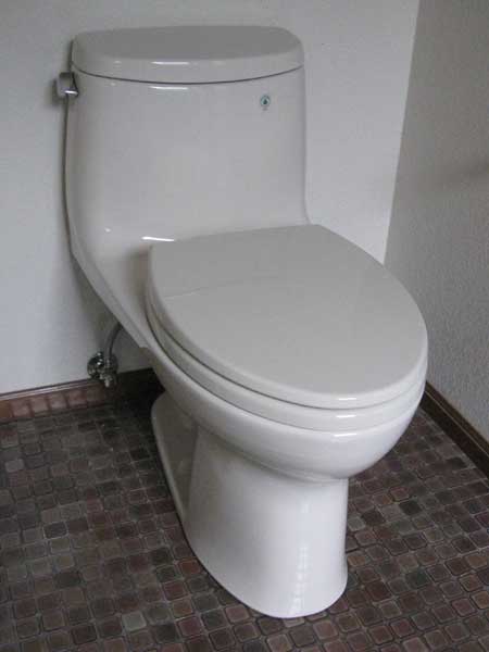

    Toto has a new model called the Gwyneth with the WaterSense Ecoflush.

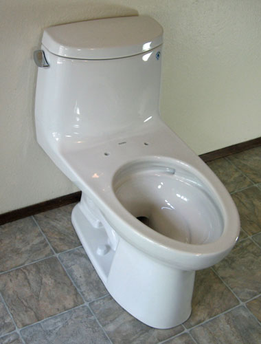

    1.28 gallons, with the double cyclone rinse and Sanagloss in White, Beige/Biscuit and Bone. The Gray and Ebony/Black are without Sanagloss. It comes with the SS114 softclose seat and is the universal bowl height 16-1/8" before the seat is added. MaP testing has given it a 500 gram rating, which in many oppions is plenty for performance. Specs for Gwyneth
    Out of the box, the Gwyneth one-piece is a pop and drop installation.
    Pop the box, and drop it on some new wax.
    The bowl hase two rinse outlets near the top of the bowl, the water swings around the bowl when rinsing. Toto calls it their "Double Cyclone"
    White, Beige and Bone come with the super smooth ion barrier glazing that they call Sanagloss. I have a bowl downstairs with the same glazing that is 2.5 years old, and it's still very smooth, like the day it was installed.

    Have had our two Gwyneths since June (Sanagloss) and have had no clogs or problems. One does need to be sure to push the flush lever down completely (no need to hold there, though) as an incomplete push can result in an incomplete flush. Expect that's the same with all toilets.
    I really like the look, too.
    And if you have any concerns about the seat shape - one gets accustomed to it very quickly and I now prefer it to the flat seat on our 1 remaining waterhog toilet. Had some doubts prior to purchasing.

    I've been using a Gwyneth one-piece for a few months now.
    The water in the bowl is pretty similar to the Drake and Ultramax, except that there is a bit less volume in the bowl.
    The flush is pretty quick and rinses fairly well.
    The comfort height is nice.
