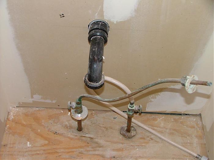

I'm in process of modeling our 1/2 bath and was planning on installing a pedestal sink.
I know I need to install a wall support between the studs -- but, I have a cold air return that runs right behind the wall where the sink will be installed -- and the duct work is probably pretty close if not flush to the back side of the drywall.
Any ideas?? Thanks.

Question, with the duct work behind the sink I take it that the drain and water supply is coming up through the floor? There is a thread here about installing a pedestal sink that has the drain coming up through the floor and there was a question about with the drain out in the floor that the sink might not work. If you can replace the section of duct work with some flex and use toggle bolts to hold the sink to the wall that might work.

The water supply comes up through the floor -- the drain is out from the wall.
The duct is off center -- just right of the drain.

In that case the duct is not "behind the sink" it is behind one side of the sink and the anchor on the left side will secure it without worrying about one on the right. Reducing the duct size is the worst idea for solving the problem. If it were really a problem, I would screw the sink to the duct.

you have other troubles to contend with
Installing a pedistle is usually a pain in
the neck no matter how it goes down...
looking at your pic, I would be willing to bet that
you will need to move the waterlines closer into the
back wall to make room for the stand...
the drain line might be off a tad bit off center too...
that is always fun trying to stand on your head and
install the trap behind the pedistle....
the backing in the wall is probably the
least of your troubles...
which you really dont have to have
for your backing you could just install some plastic
anchors and mount and glue the hanger to the drywall if necessry...
with a pedistle sink ,
the weight is held up by the stand under-neath it....
you could actually just put the hanger on the wall
with plasit drywall anchors,
and glue the pedistle in place with DAP and get by fine
it wont go anywhere unless someone decides to
make love on it...
we run into them all the time that were glued to
the wall with silicone,,,,
of course they dont come off too easy years from now
but that is someone elses problem:D
Looking at what you got , I too suggest a vanity

Yep -- I've been measuring some different pedestal sinks and it looks like I will have to move the water lines closer to the wall.
I'd like to center the pedestal -- but since the drain is off center -- will this be a problem??

The drain being off center becomes a problem if there is not enough room in the slot of the pedestal to rotate it into position
Looks like the drain is off center by 1-1/2".
I'll measure the slots of the pedestals -- to see which one would work the best. I guess the wider the better.
