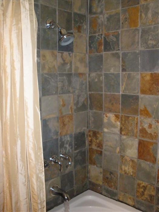

    It is my understanding that most jetted tubs cannot be installed with a showerhead that is located above the tub. Is this a true statement and does anyone know where I can find the installation instructions to back up this claim? Thanks in advance.

    Not necessarily true. Most jetted tubs are available as drop-in without a tiling flange. Many of the manufacturers offer an add-on tiling flange. As long as you have one of these (one with a factory tiling flange is preferable), a shower is possible to produce that will be water-tight.
    Now, considering the recommended monthly maintenance of a jetted tub, you may not want to use it daily for a shower...keeping it clean around the jets when used in that manner could be an issue, but doable.

    That is not the case, but most jetted tubs are installed in a deck with a tile surround. In these installations a shower head will spray water outside the tub and that water will eventually end up on the floor somewhere.

    This is where I'd recommend an airjet tub. We bought ours (bain ultra) and had a tiling flange installed and after daily showering, run the blower motor program to purge any water residue. Been working great for 6 years now.

    A bit confused. How does running the air motor remove water around the outside of the tub on the tile border?
    21,376
    HJ, it doesn't, but does dry out the internal passages, unlike a whirlpool, the air tub turbine likes to run dry, as opposed to the pump. An air tub is much easier to keep sanitary verses the maintenance required on a whirlpool.
    If the tile flange is installed, and the walls tiled as if it was a tub with a built-in tiling flange, done properly, it should work as a normal tile-in tub. The trick comes in how you handle the outside edge.
    HJ, Jim beat me to it.
    Ours is a drop-in design fitted with tiling flanges for the typical alcove installation - no water pools on the edges and the tub is fitted with a front skirt for plumbing/motor access.
