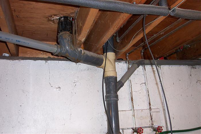

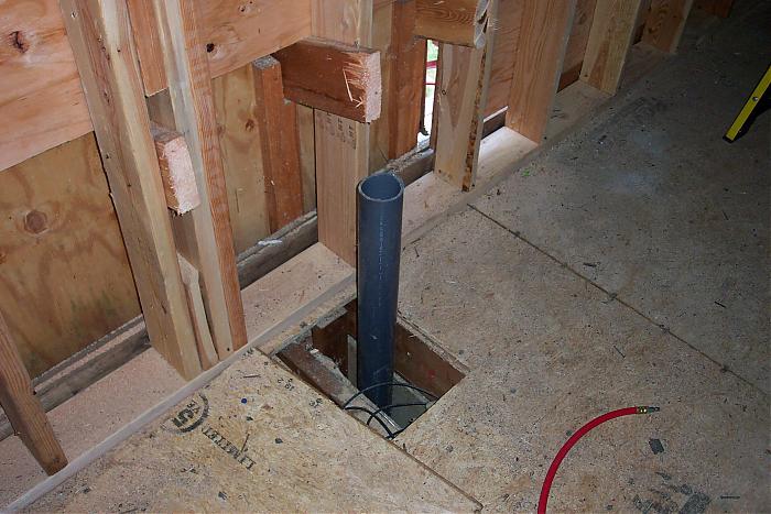

I am adding a new bath and it is located directly above my existing vent stack. I had originally planned to put a series of bends in the stack in order to move the location of the vertical riser into the new walls above. While looking through the IRC 03 (effective in CT) I noticed a paragraph that stated "waste stack shall be vertical, and both horizontal and vertical offsets shall be prohibited." I am interpreting this to mean my original plan to offset the waste stack is not allowed, but I'm no plumber so I figured I would throw this out there and see what you all thought. Any advice/insights would be much appreciated. Thanks.
