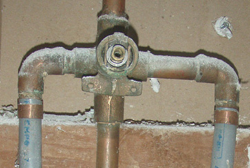

    Default Shower valve replacement
    Well, after ripping out my walls doing a remodel on the bathroom, I've decided it would be wise to update the shower valve. The only issue is that the feed lines are plastic with everything else being sweated copper. The install is the original 20 years old), and I'm not sure what they used to secure the plastic feed lines to the copper lines, or how to replace it. I've attached a picture of what I'm talking about.
    All the new valves I've looked at also appear to use a threaded fitting now. I'm not sure how to move forward with this. Any advice is welcome.
    Thanks in advance.
    23,518
    Default Pb
    I hate to be the bearer of bad tidings, but your plastic pipes are polybutylene, which are the "bad" ones. Unfortunately, or fortunately depending on how lucky you feel, 20 years was too long for the class action replacement, but maybe you will not have any problem with them. The Delta universal body with a 1700 trim, or 1700T if you want thermostatic, is one of the best valves, in my opinion.
