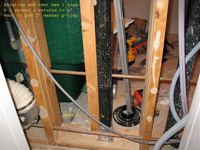

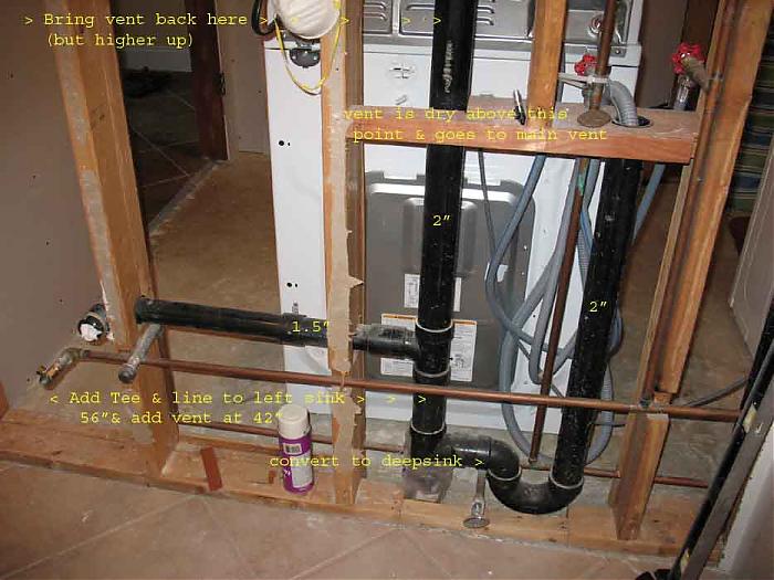

I'm doing a bathroom/laundry rehab and I have two ?? that I can't answer.
1. I have a double vanity that was redone years ago and they added the extra plumbing under the sink and used white flexible stuff. I'm redoing it with copper and ABS in the wall. I saw a previous post from "lindalou" 05/25/08 and I think it answers my 1st question. To add the left sink I will add a sanitary tee below the original one and vent that line up and over to the 2" vent. I also will convert the existing washer drain to a deepsink drain. (see vanity photo)
2. I then need to add a washer drain to the other 2" vent which has a sink and shower from upstairs bath on it now. Can I do this or will the washer have problems? Both of the 2" vents go to a main 4" stack less than 40" away and I believe they drain straight down into the 4" line heading to the street.
Any comments will be greatly appreciated.
Tnx
Bob
