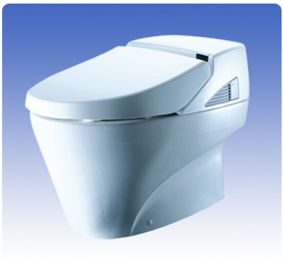

The TOTO Neorest 600, model MS990CGR toilet Review

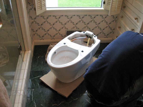

Below is one just out of the box, ready to start installing.

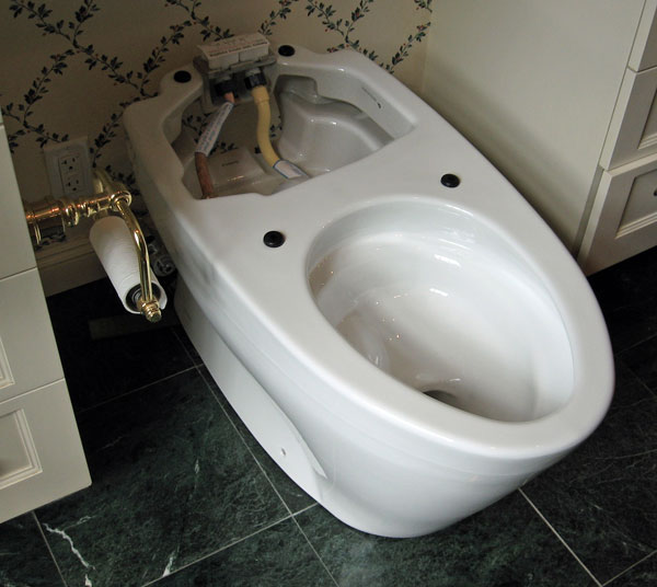

We have already lifted off the washlet part, and set it aside. In the bowl, is the flange adapter and wall shutoff.

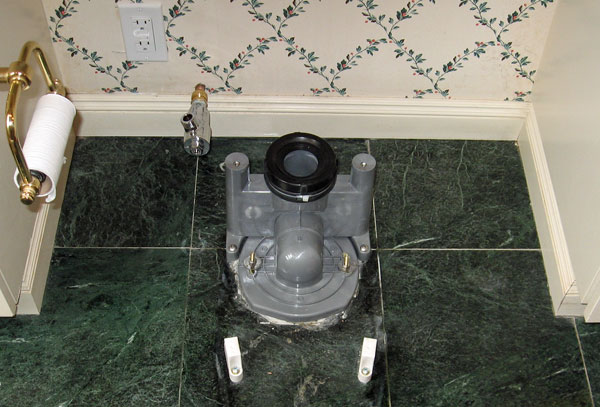

The back contains the floor template and mounting blocks.

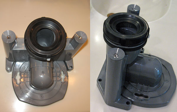

Here are two views of the flange adapter. We will be drilling six holes into the marble floor, and using anchors with screws.
Notice the upper drillings for the bowl mount from above. The bowl has a spigot that drops into the rubber sleeve.

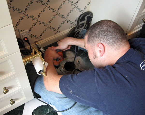

Jamie of Love Plumbing & Remodel drilling the floor to take the adapter.
Notice the outlet for the electrical that the washlet uses on the wall.
Whoever had replumbed this home had put in some nice quiet cast iron drains.

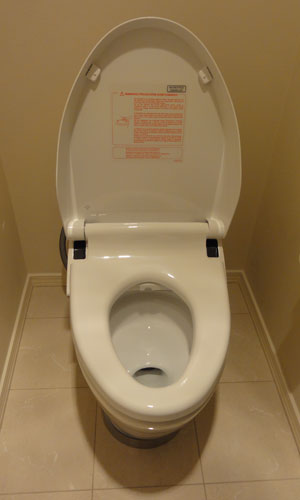

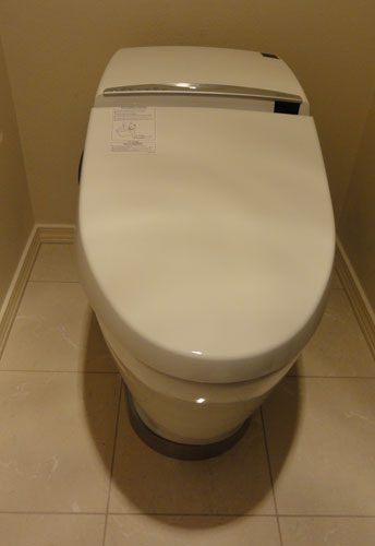

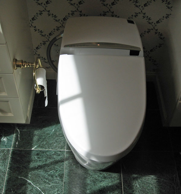

The adapter in place and ready for the bowl to be dropped down.

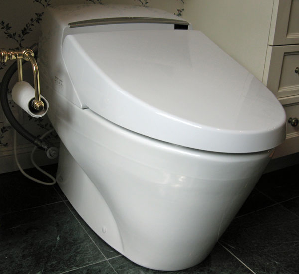

Installed with the Washlet attached. The pictures don't show the clear caulking yet, that was done after the pictures were taken.

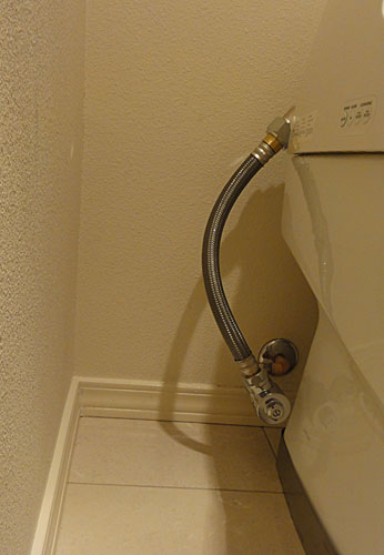

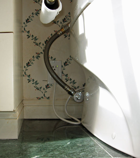

The Neorest comes with it's own supply and supply tube. It's a 1/2" female thread on the back of the shutoff. Specs call for the shutoff to be a little higher off the floor, and 11-3/4" to the left of center. If someone knew that before the walls were in, that is where you could put it.
This bathroom was like most homes with the shutoff closer. The top fitting swings, which is good, it allows the connection without kinking the supply.

The remote control was mounted on the cabinet to the left as you are looking at the bowl.

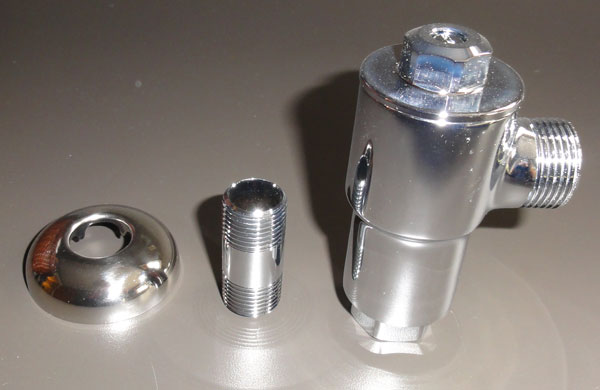

The Neorest comes with it's own supplied shutoff with 1/2" threads.
The 1/2" you have will work fine, you many need to move it some during installation.
Make sure you use the supplied hose connector for the water supply to prevent restriction.
Depending on how where the shutoff is located in relation to the bowl, makes a difference on how it's tilted.
If you look at the picture here, you notice how large the shutoff is?
There is a removable screen filter in the shutoff to prevent grit from clogging the bidet functions.
The can be removed and cleaned from time to time.
The connector is larger than normal, that is where you wouldn't want to restrict it.
A standard toilet supply that you find at the hardware store will not work.
You must use the TOTO supplied larger water supply.

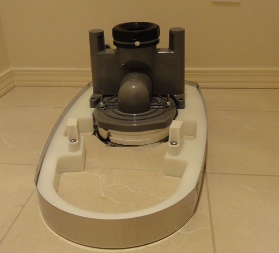

TOTO also makes an adapter, THU9046 to raise the Neorest 600 to an ADA height.
Here are some pictures.
The adapter
Moving the shutoff toward the left
Seat down
Seat up.

I picked up a used Neorest 600 in perfect condition, and will be installing it in my home. I have all the parts, EXCEPT for the bowl installation template. I had thought I would try to wing it without the template, but am guessing the correct placement of the little blocks for the 2 front screws will be difficult. I'm wondering if anyone has the template and would sell it to me, or if someone knows where I can purchase it from some dealer. I can't seem to find the template available online from any TOTO parts sellers.
Thx for any help....
WJcandee
Wise One
3,181
170
63
New York, NY
They have some templates online, albeit not for the 600 and not true-to-size. However, I would call Toto customer service at the number on the web site totousa.com and a friendly agent there probably would be willing to mail you one. 1-888-295-8134
