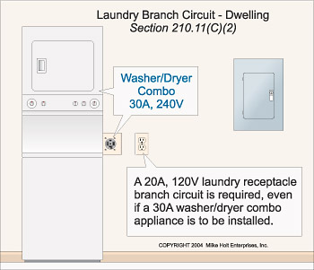

    Nope 2002, (maybe earlier) and I never should have said a washer needs a dedicated circuit, a laundry receptacle is required...
    210.11(C)(2) and 210.52(F) requires a receptacle outlet served by a 20A branch circuit to be provided in the laundry area of a dwelling unit.

    Quote Originally Posted by Chris75 View Post

    Now I'm with you.
