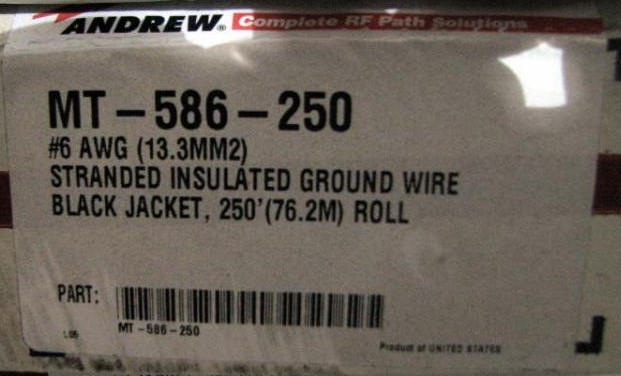

I need to run 50' of wire to carry at least 60 amps (220) to the subpanel in my attached workshop ...
Can I use four strands of the wire in this picture?
Here is the auction description:
#6 AWG STRANDED INSULATED GROUND COPPER WIRE 250' ROLL
Wire reads: REPUBLIC WIRE 6 AWG TYPE MTW OR THHN OR THWN-2 600V OR GASOLINE AND OIL RES II (UL) OR AWM-VW-1 SUN RES OR C-(UL) TYPE T90 NYLON OR TWN 75 E167613 FT1
Thank you!

Why dont you just go buy some 2/3 SER cable? good for 90 amps, or some 4/3 SER cable good for 65 amps. that wire is not that expensive.
Jimbo
8,918
San Diego, CA
To be specific, that ground wire does not carry an insulation rating which would allow you to use it for "hot" conductors. It may be perfectly fine, but it is not rated...so don't use it.

FYI - As to the label on the package and it saying "Ground Wire", the Andrew company sells large satellite and microwave dishes which require grounding. Thus I think they are "repackaging" this wire and calling it ground wire.
Yes. I see, and that answers at least some questions I had. Thank you.
I do not know what SER cable is, but I will find out and take a look. There is a very reputable supply house nearby where I can get a contractor's price through my employer.
I did some homework on the auction wire and I believe it might be okay (including the temperature rating) if the conduit is sized properly and I color-code the four strands, but I will not likely spend the time to first be absolutely certain about all of that unless cost becomes a really big issue.

Unless that "free wire" is a Chapter 3 wiring method forget about it.
