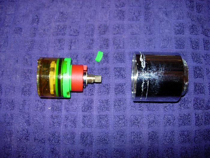

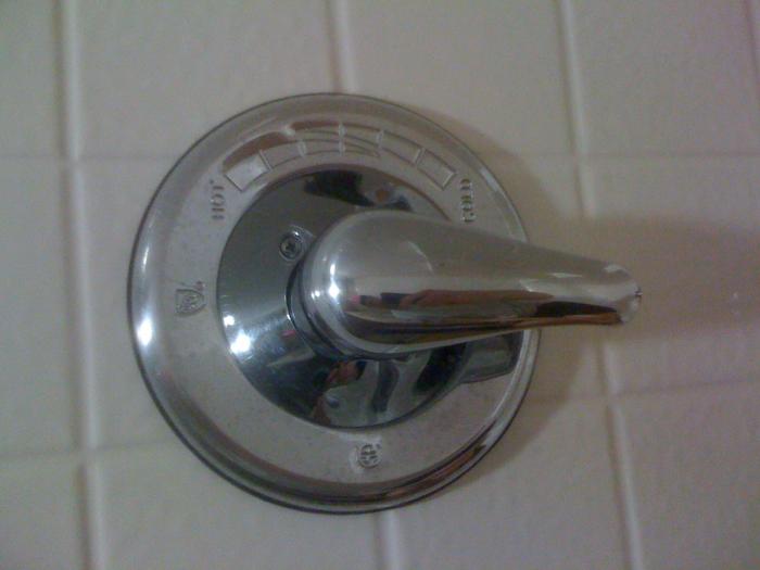

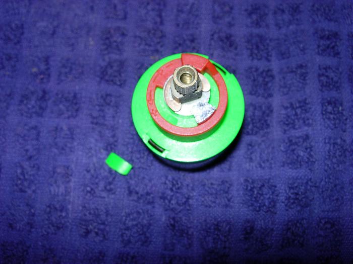

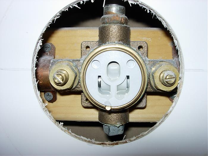

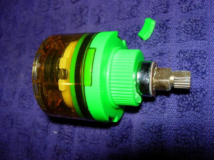

    I am trying to replace the shower valve cartridge for my single handle shower faucet. The plastic lip of the valve cartridge is broken . . . unless I turn my handle just right, my shower will leak! My problem in replacing the cartridge is that I don't know who the manufacturer is of my single handle shower faucet. Because I couldn't find a replacement, I actually glued the broken plastic piece back, but that only worked for about a month. Does anyone have any suggestions for tracking down replacement cartridges? The only identifying information on my faucet is "UPC" and "CSA", which I suspect is not unique to this manufacturer. Attached are some pictures . . .

    Have a look see here...
    http://www.arpny.com/
    Click on "single lever faucet cartridges"
    You will find it I guarantee it!
    I would have looked it up for you except my PDF reader is acting up tonight and shutting down by internet browser...
    Dec 2007
    7,463
    Okay I got it to work finally!
    That cartridge was used by Gerber, Harden Brass, and Matco-Norca and is available at the link I posted above.

    I think this is the one I have too. I'm trying to replace the handle and need to either figure out how to remove the whole valve assy and replace it, extend the shaft on the cartridge to 3" to accommodate the new handle assy, or replace the cartridge with one that has a long enough shaft. Please help.Name:  photo.jpg

    UPC is NOT a brand name. It is the "code" seal of approval granted by IAPMO ( International Association of Plumbing and Mechanical Officials). UPC stand for Universal Plumbing Code. Most jurisdicitions require all plumbing materials to be approved by a recognized approval body, like UL for electric). IAPMO is a universally accepted approving agency.
