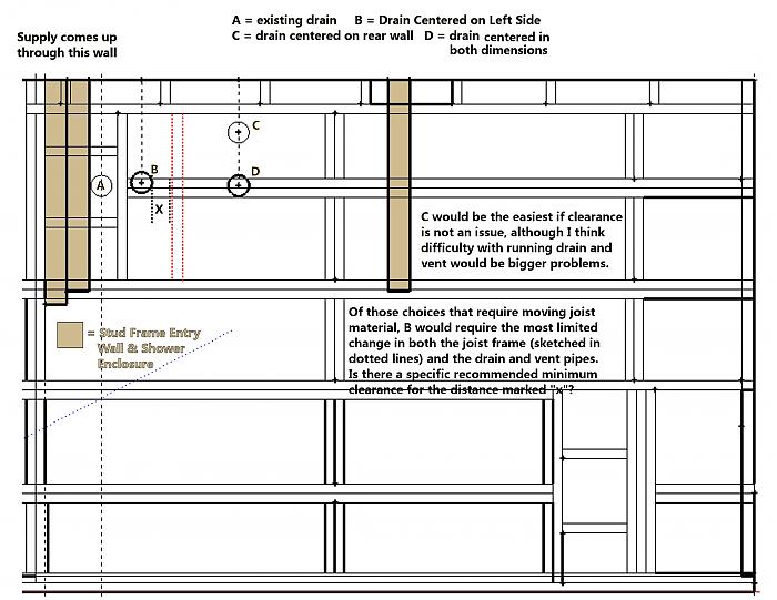

1. I have been unable to find any printed info on the topic of roughing in a shower drain in terms of the joist frame. The original drain was positioned in an opening involving three adjacent joists, with the middle of the three cut short and the three tied together with a transverse board butt-ended into the cut joist and toenailed into the two on either side, as if to make a box for the drain. I believe that was necessary because otherwise the middle joist would have been in the path of the drain. If I choose to use a shower pan that would require a similar treatment to make room for the drain, are there specific minimum clearances that must be considered?
2. If I elect to use the pan with the drain centered on the back wall or I devise my own pan, in either of which case the drain would not fall directly in the path of a joist, are there required clearances, anyway (as for example in the former case, is 1 13/16" adequate clearance from the adjacent joist, or does it need to be farther away)?

I have attached a jpeg image of the joist frame with the intended stud frame in place to help flesh these questions out. I intend to sister the joists, which are only 2 x 8's, to stabilize the floor for tiling. This image started out as my plan for that, and I sketched in the stud frames for the wall to be rebuilt and the two ends of the shower enclosure, along with the site of the drains I have outlined.

If you can find a manufactured pan that meets your needs, they can put the drain where they want and still maintain the needed slope. If you build one, you can, too, but that can be problematic. You need 1/4" per foot from the corner to the drain on the longest dimmension. This means if the drain is not centered, that you need a much steeper slope on the shorter distance in order to maintain the proper slope on the longer end as it has to drop the same distance in a shorter length. If you're tiling it, it makes it harder to get a decent looking transition, and means using smaller tile is better.
Check out www.johnbridge.com for tiling help. I'd probably tile the pan I built, and put in a header so I could center the drain properly. ALso, keep in mind that today's code requires a 2" drain for a shower...an older one may have had a 1.5" drain, and you'll have to replace all of it back to where it gets to at least 2".
While you're looking around, check out www.schluter.com and watch the videos of their shower system - Kerdi. A neat way to make a totally waterproof (rather than water resistant) shower, from the floor to the showerhead.

I decided to bite the bullet, order a prefabricated pan with a centered drain, and cut out an opening in the joist system to allow easy clearance of the drain. I am hopeful the issue of slope on the drain and vent will not be too much of an issue. By putting the drain in the same line as the initial drain relative to the joists, they should be following their initial course, just at a steeper slope, and if anything it will simply require notching out a block to allow placement of the vent pipe. That blocking I'm putting in to to help tie the subflooring down securely but it does not represent a true structural support surface.
I've included the diagram of the altered joist system that I have planned (actually, I tried to, but I'm not sure it went through!).
