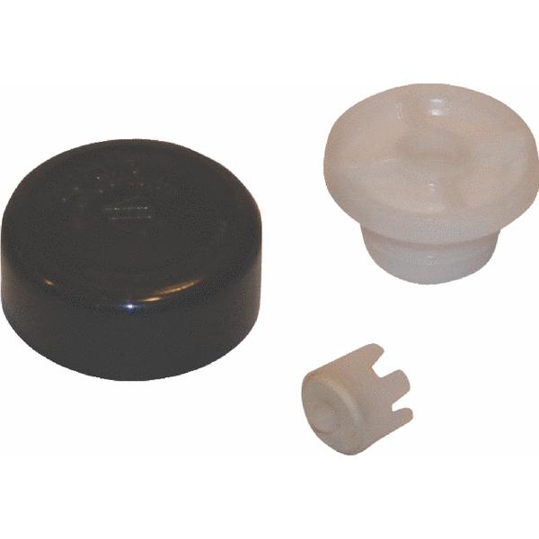

    Thank you both so much for your responses. I found a repair kit online and I think I've attached the pic. The piece that I found on the ground is the littlest one, except mine has a little black washer on the peg. It's on a website called Do it best.
    It's just 3 pieces, the cap, a plastic/teflon threaded piece that sits in the faucet that the cap screws on to, and this little round piece with teeth on one end and a washer that sits on a little peg.
    Logic tells me that it doesn't sit on top of the threaded plastic piece because putting it there won't allow the cap to seat. So it must go under (inside) of the threaded plastic piece. Can I pop off that piece and drop in the one with the washer and recap it? If so does it go teeth up or teeth down?

    Since there is no 0-ring, then the legs go down.

    The picture doesn't show an "o" ring but the piece I found on the ground does have a black o ring (I called it a washer in error in my earlier posting) on the nipple that you can see in the pic of the smallest piece.
    So do I pop out the piece (the other one in the pic) and put the little one with the o-ring and teeth on it inside with the teeth down? Then put the piece I popped out back in and screw the cap on?

    Yep... Sounds like what you need to do.
