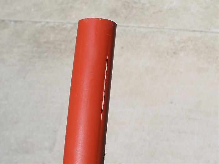

    DIY Junior Member celiason's Avatar
    May 2008
    NC
    Default Working on posting a picture...
    Redwood,
    Thank you for your interest. I will work on honoring your request for a picture. The splits are lengthwise, about 1-2" long and I will have to use a "macro" lens for the close-up. It almost looks like a a split along a "seam" in the spot. There are no apparent scratches or injury to either the inside or the outside of the PEX. If I look down the interior of the pipe, I can see light coming through the split even though it is very narrow. (The split was really visible when water was coming through it and spraying in the attic!) I have sent one of the better samples to the manufacturer for analysis but I will see what I can show you...
    I did not mean in anyway to belittle the plastic piping industry or PEX products. From my research I have learned much about it and agree that in light of rising copper costs, it can be a great solution to affordable piping. I have also learned that any material can have shortcomings based on different applications. I also understand that even the best manufacturer can sometimes have a problem with quality control and have a bad "batch" slip through. I can only relate my experience with this particular brand/batch and what is occuring. (For the most part, I think PEX is OK!)
    I have tried to provide as many details as possible and address all questions and I check back daily to this board and continue to search for answers. Until I hear from the manufacturer, I myself have no idea what is going on.
    I am not running, just trying to wait patiently until I have an answer...
    Believe me, I am very frustrated and waiting and searching for answers is difficult...until I know something, I don't know how to proceed...
    Please bear with me while I get the photo up...(I have three children who are out of school now and they are requiring the majority of my time, an addition to my work...):cool

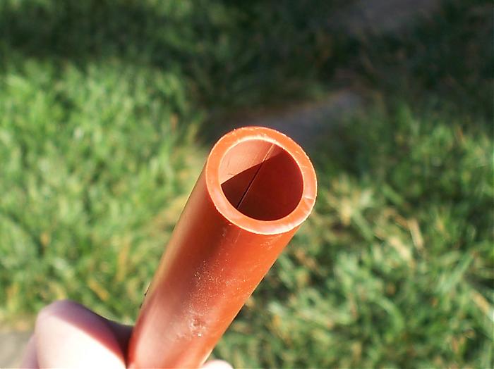

  9. #24
    May 2008
    NC
    Default pictures...
    Redwood,
    Here are some pictures I took of the second portion of pex removed...each picture is from the same piece of pipe at the same split location... They are the best I could do and I hope they come through OK...please let me know if they don't ( I am a little behind the curve when it comes to this technology stuff, but the children are helping me...)
    If you can see, the split happens in what looks like a "seam" along the length (note the outside) and appears to start on the interior of the pex, and on the outside you can see where the water actually came through (the sidewall of the pipe split through to the outside)...what could cause this? There are no scratches on the outside...and this is nowhere near a fitting, just in the pipe itself! I am hoping that the engineers and technicians at NIBCO/CPI can find an answer for me. I have receipt confirmation for the sample I sent them from 6-13-08 (Friday the 13th!) and have been instructed to wait 30 days before calling them for results...It is hard to be patient, but this board helps alot! For the most part, it appears that pex is usually pretty reliable (as well as any other material it seems, based on where you use it), and cost effective...
    Anybody else have a similar experience? What should I expect from the manufacturer? Any advice or suggestions are welcome...
    ...hopeful and optimistic...
  10. #25
    Dec 2007
    7,460
    Wow! The sky is falling!
    That is the first tubing related failure I have ever seen or, heard of!
    It looks from the end view that the damaged section extends past that point I do hope that it was cut back until any evidence of the cut inside was no longer showing when the repair was made.
    I am very interested in what they find was the problem. I know that any manufacturer would be very interested in finding the root cause of failure and I'm sure they will come up with answers.

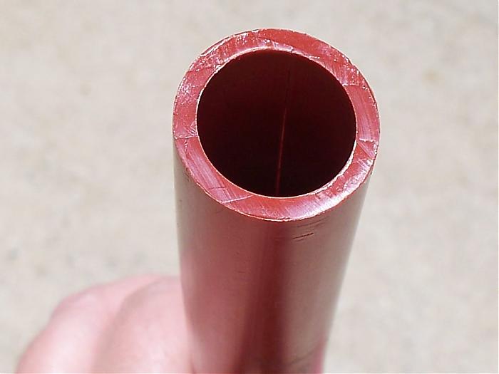

  12. #27
    May 2008
    NC
    Default ...one more picture...
    ...not to keep beating a dead horse...
    ...here is a picture that shows light coming through the split in the same piece of pex (tricky shot in full sunlight)...
    (It looks like the pipe started splitting from the inside out and eventually the water pressure was too much.)
    To repeat, residential application, county/city treated water, PRV, expansion tank, gas water heater, all professionally installed to code (no DIY) and manufacturer specs/clearances, no UV exposure...
    ...sigh...
    ...any ideas?...
    I'll keep checking the board, but I probably won't post for awhile until I hear something from the manufacturer. Thanks again to everyone and their 2 cents. I appreciate it!
    -c
  13. #28
    Dec 2007
    7,460
    Yea I know it appears to have started inside, Thats why I was asking if it had been cut back far enough when the repairs were made...
    Well I'll definitely be watching for when you post what they say...
  14. #29
    Nov 2005
    Central Florida
    2,506
    I've never even seen a piece of PEX up close and personal, but I'm surprised there's any seam at all -- If I were making plastic tubing, I'd use a seamless extrusion process. It definitely was a weak point in this sample.
  15. #30
    Dec 2007
    7,460
    Thats just it Mikey, There is no seam in PEX it is polyethylene extruded as a tube then molecules are cross linked by one of several methods. Its pretty tough stuff!
