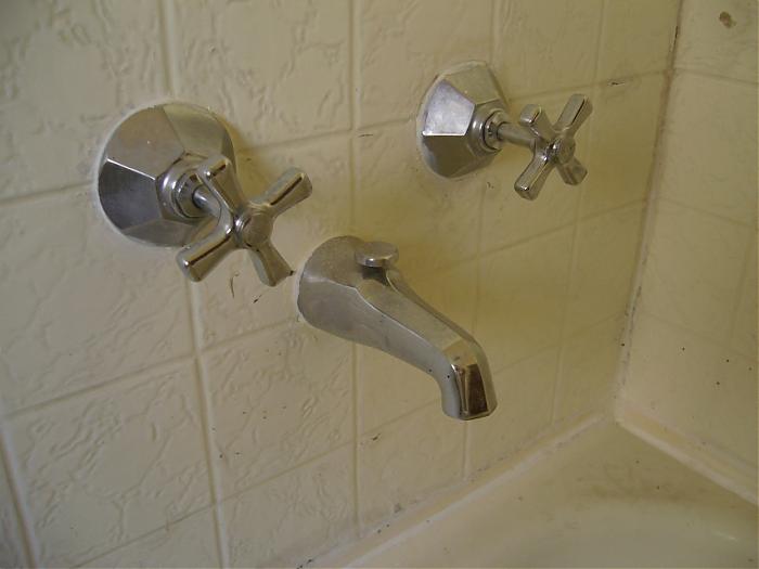

    I've installed a new tub surround in a 1948 duplex. As a result, the flange that covers the stem and packing nut will no longer attach properly.
    I've included a photo of the faucet handles before the new tub surround was installed. The problem is the new surround is thicker, and the threaded piece that secures the pyramid flange(trim piece) isn't long enough to reach the threads on the packing nut.
    Does anyone have any suggestions about where I might obtain one of those trim screws that's a little longer? If I can't, what are my options for extending the pipe/stem out of the wall about 1/4" more?
    Thanks for the help.

    You might consider shortening those covers. A skilled machinist could do that without damaging them, or maybe you could do that at home in some other way. A belt sander comes to mind. In any case, the cut edges against the wall could/would ultimately be lightly caulked, and you would not have to be concerned about rust since those old parts are likely chrome-plated brass.

    Those escutcheon nipples are a common item at many plumbing stores and ALL faucet parts stores. You buy a 12" length with the correct thread, (take you old one with you), and then cut off what you need. That is probably an American Standard faucet according to the handles and escutcheons.

    HJ - excuse my ignorance, but when you say escutcheon nipple, exactly what part of the faucet assembly are you referring to? (I'm trying to envision what part would be 12". I suspect it's the entire stem/packing nut assembly. If so, you're suggesting I replace the entire thing, only at a different length...)

    THe nippple referred to is the threaded "pipe" dealie, that connects to the packing nut, and allowe the pyramid shaped escutcheon to be attached. Get a long piece, and cut off the necessary length

    The part in the picture below labeled #7 is the escutchion nipple.
