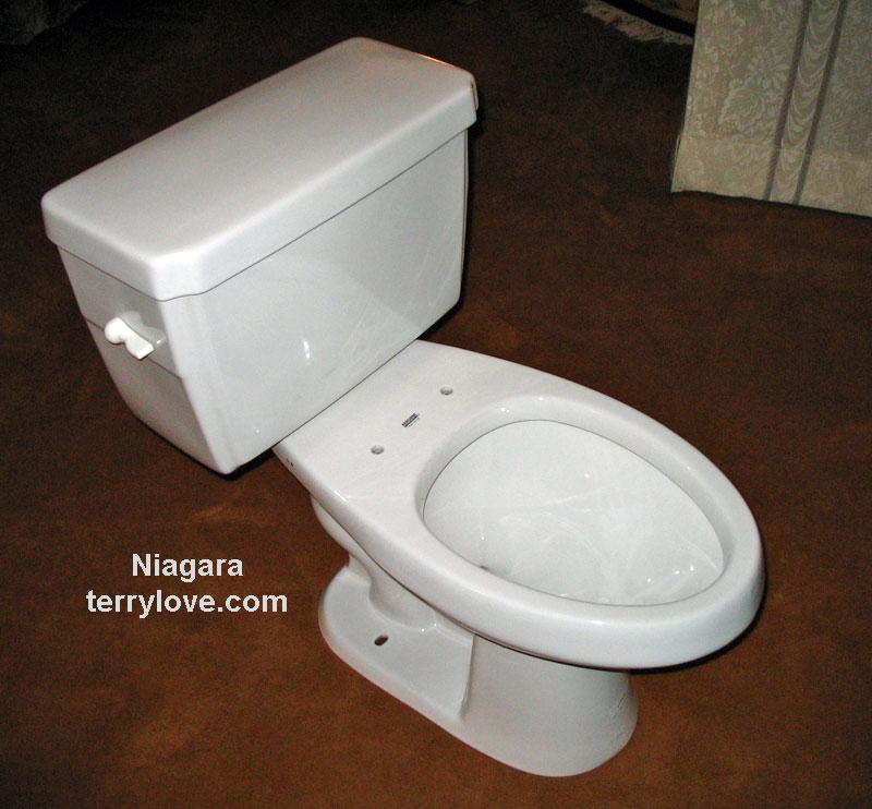

    Good Morning and thanks for everyone that dispenses helpful advice and tips. This is a great forum for those that are experienced and those that are DIY'ers. As a first time DIY'er I have undertook a bathroom remodel which includes relocating a toilet and re-tiling the whole bathroom as well as relocating the sink pipes so that they come out of the wall. The plumbing has been done, the walls are finished, and next steps are the tiling and a toilet purchase.
    Does anyone have any thoughts regarding Niagara Conservation toilets. I am looking to install a 10" rough in elongated toilet. Ideally it is water conserving, and "efficient" and within a price range of 250.00 - 375.00. Does anyone have any suggestions that fit this criteria. I was looking at a kohler wellworth. I was also told that the Toto 10" conversion kit or any other conversion kit to a 10" rough in size was to be avoided. What are your thoughts on that. Thank you all for your time and consideration reading this.

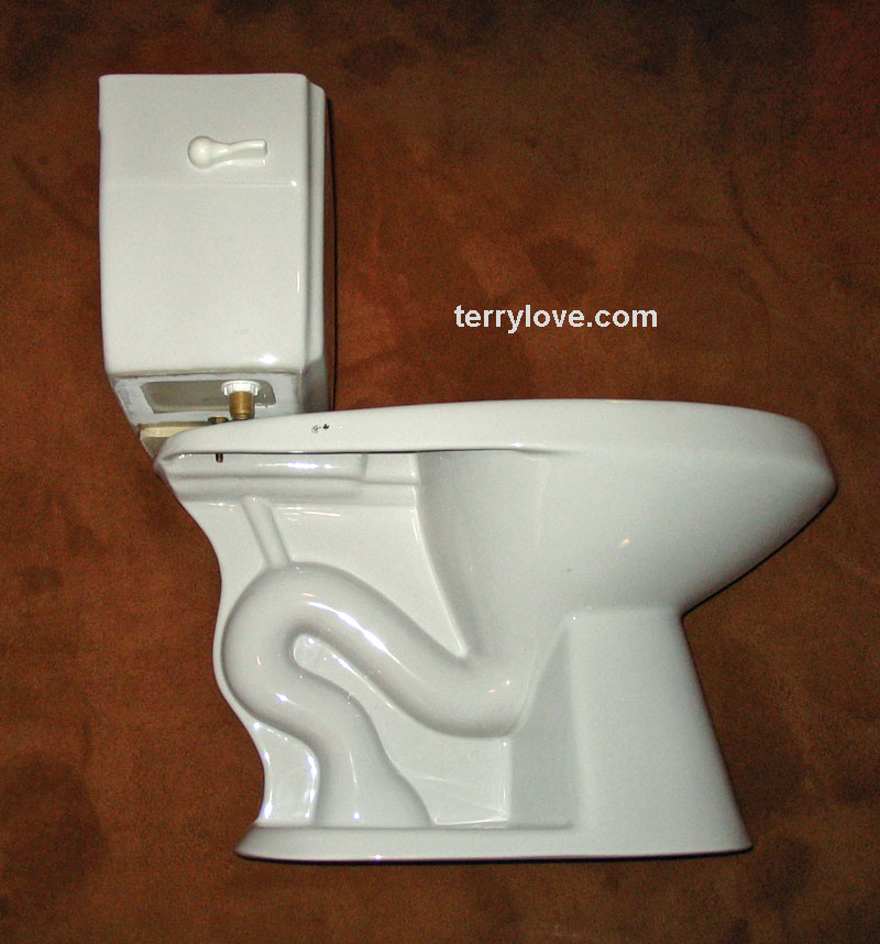

    The Niagara has a plastic tray that you tip to create a flush.
    It's a basic builder grade toilet are far as quality goes.
    The footprint is fairly small, so if you have a wood floor, the old outline is likely to show.
