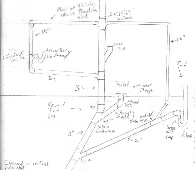

This is a plumbing plan for my attic addition and would like your opinion. I have limited space below the floor is the reasoning for using a 45 degree toilet flange. I have about a 25' run before the line goes vertical into the main line under the slab. The city inspector already hinted that I should use a 3†vent, for what reason I am not sure.
