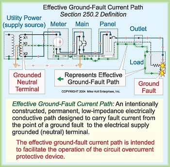

If the electrician said that it made no sense to him either then I am saying that he ain't much of an electrician and maybe you should not ask him/her any more questions.
Although this is not the best installation it does show how the equipment grounding and grounded (neutrals) MUST be installed.
Note that the grounded (neutrals) do not land on the installed bar for the equipment grounding conductors. That would be a hazard in so much as the panel enclosure would then be part of a current carring conductor.
