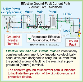

    Quote Originally Posted by Mikey View Post
    I guess my next question would be why not use an independent ground at the sub instead of running a ground conductor back to the main?
    Look at this picture and see if it makes any sense... See how ALL current from faults MUST go back to the utility transformer, if it didnt, it would NOT open the overcurrent device.

    Thanks for that diagram -- it helps a lot. I guess what they're saying is there's no guarantee that an independent ground (or the utility ground, for that matter) is effective enough to carry enough current to open any of the circuit breakers in the hot path -- thus the need to provide a path to the utility neutral. GFCIs seem to solve this problem in a much better way at the individual circuit level.
