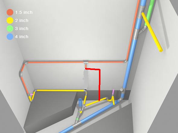

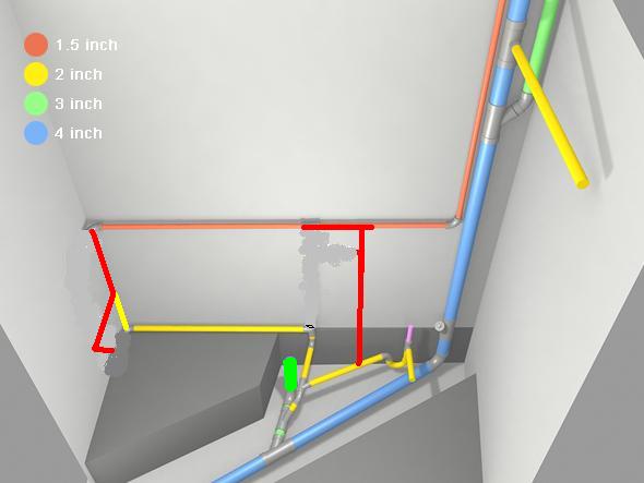

    If you do this, you will be in the good books with any Canadian inspector and or Canadian juresdiction. Your sizing of venting and dranage is ok. We generally do not use any 1 1/4" pipe and fittings any more because they are double and triple the money than the 1 1/2". (just a cost factor)
    You are allowed to use 1 1/2" for your bathtub drain. 2" is optional. The waste and overflow assembly kit for the bathtub will be 1 1/2" anyway

    Cool - thanks Krow - the red pipe in the revision you posted... can that go up straight up, or does it have to be exactly as in your drawing?
    - ill start preping everything now and leave that one section until i hear back from you - thanks again

    The sketch Krow made is in line with what I was suggesting. I would however, break out some more slab and run the lav drain more direct with fewer elbows and shorter horizontal runs. Both have effects on reliability. 2" is a minimum Dia. under the slab.
    As with anything there are a few different ways of doing it. Below is a sketch of what I was saying. I did not show connection details you seem to have a handle on that. Please excuse my rudimentary drawing... What did your program cost? Where is it available?
    If you can go straight, then do it. It will save you on fittings. The best path from location A to location B, is in a straight line.
    Redwood suggested a couple of alternative routes to take, which are just as good. There are many ways to skin a cat lol

    If you want to stick with the pic I provided, maybe these slight amendments might suit you better

    At this juncture, I believe the last image to be complete and final - thanks mainly to Redwood, Krow, Mikey & Jimbo + everyone else too.
    If anyone has any questions let me know - once again, a big thanks to you all.
    novicepiper

    That last sketch should do well for you!
    It certainly looks a lot simplier than the one you started with huh?

    ok - sorry about this how would I vent the kitchen sink or is it already vented in the main stack? ( going on what i think i have learnt thus far and this willl be really painful for me if im wrong) if the main stack acts as a vent for the kitchen sink will discharge above cause it to siphon the trap or push bubbles through the trap - i guess maybe i should tie it in above the 2nd floor toilet or does it just have to be above the kitchen sink in the main stack?
    I did a quick repair on the soil stack (CAST IRON) the other day - this is how this all started out - i replaced 4 ft of cracked stack in the basement and replaced it with ABS 4" I tied the waste into the stack and vented by accident to the 2 inch vent seperate to the stack and now when i flush the toilet on the second floor - there is a heavy thump from below when its about half way down the flush - there are no weird smells or anything it's just really loud when your in the bathroom. like a mini earthquake - any hows, enough of the blah blah - basically i just could do with a quick answer of how, what and where i tie the kitchen sink in re vent - the actual waste will be joing into the 4" stack as per agreed visual earlier - once someone answers this i think im good for the preposal and maybe start it soon

    The kitchen sink is probably vented by its own vent and not the stack. Or, tied into the stack above all the drains.

    anyhows it sort of made sense to me to vent the sink obove evrything else on that stack. that was also based on mikey's cool explanation too.
    It all depends on the location of your kitchen sink p-trap. If the p-trap is located at the end of that pipe, then it needs to be vented above the flood level rim of the sink or above the top of the sink level. I only assumed that the kitchen sink drain extended further up from its current location (As in the pic). Its was hard for me to determine where the next floor starts.
