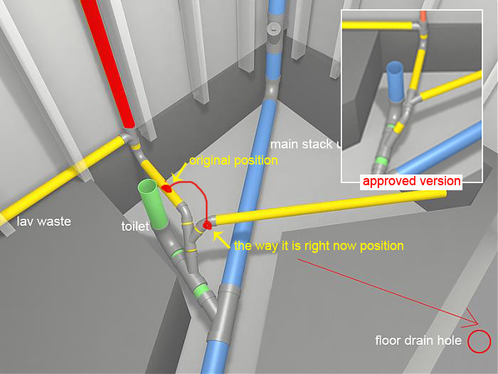

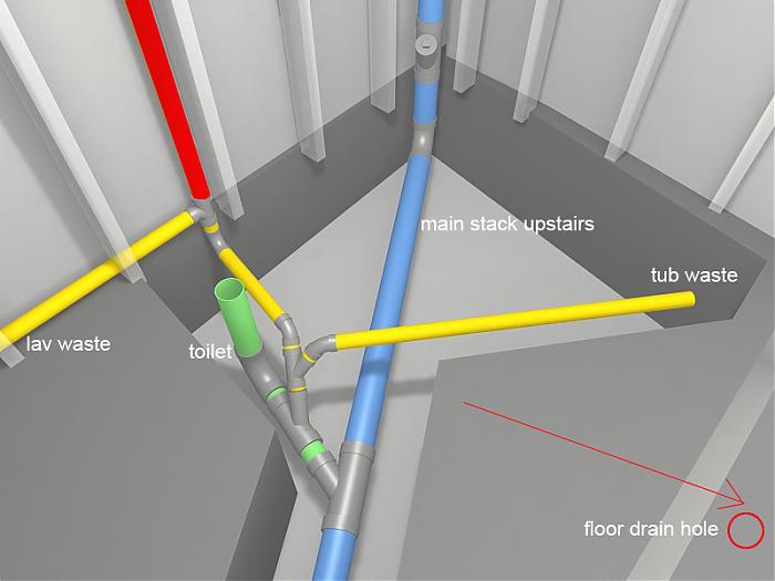

    Not a Master Plumber novicepiper's Avatar
    Apr 2008
    CAN Toronto GTA
    97
    Default plumbing
    there has been a few holdups etc etc & a few changes to the layout...the plumbing is as exactly as it is in the image.
    BLUE PIPE = 4" (upstairs to roof)
    GREEN PIPE = 3" (toilet)
    YELLOW PIPE = 2" (waste from lav & (can i use 2" for tub based on pipe sizes for rest of plan - or should this be 1.5?))
    RED PIPE = 1.5" (venting this bathroom set only) joins to main stack in roof.
    3 questions really
    1) Is this correct so far - i had to flip the tub to the other end!
    2) we need a drain hole in laundry room (how would i join this in to the existing pipe configuration) - i know i use 2"! ...
    3) there is also a dehumidifier pipe thats runs that needs to be attched somewhere - i was thinking of running wyeconnection off the tub vent line about half way and running it up the wall vertically above the highest point - would this work (it would be behind the trap so no gas could escape and its above the highest flood point. so this is probably not going to work and its most certainly not prob code.
    I think this needs to be attached to the drain hole - but i dont know how to do that without cutting into the blue pipe and venting it through the yellow (but that's prob wrong too). i need some help... i used my torch to call batman, but he's not responded..
    thanks for any help
    novice piper

    Since our approval something has been changed. The tub has lost its wet vent.

    Quote Originally Posted by Redwood View Post
    the tub had to flip (as in 180).
    how do i get the venting back to the tub. MAN i thought that would work. and the floor drain situation - any help would be good, nay - FANTASTIC. im depressed now.
    ps the only thing i changed was the angle of the pipe to the tubs waste!?
    my foolish head thought that the only way to get the waste from the tub on the correct angle was to do it the way i did i dont think i could have done it the approved way and had the water run correctly through the wye......im so so disapointed with myself about this...

    Default anybody out there -please help
    could someone have a look at this please - krow - redwood anybody - i appreciate any response i just need to get this floor down now - thanks in advance
    please look at image above this message for existing appoved section (included within image top right in box) and the way it is with flipped tub.
    i was thinking of connecting into the 4" with 4x4x2 WYE and running a seperate vent from said 2" (45 angle) that connects to the vent (above highest fixture) center of image with a 90 elbow. also was wondering if i could tie in the floor drain using a 2" WYE (tie into the tub waste line)- that prob makes no sense at all. - suggestions would be greatly appreciated
    thanks novicepiper
