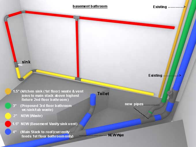

:) Hello - Could someone please look at the attached image and let me know what you think (its my first attempt at this). Any advice, giudes etc are warmly received.
Room Dimensions - 9'ish x 5'ish
Main stack to red vertical vent pipe = 59"
Main Stack to Proposed wc pipe = 48"
I'm trying to achieve:
Basement A - plumb wc, vanity sink and tub into the basement. I have added the wye in the image to the 4" main horizontal stack. is this the right size 4" and placement?
Third Floor B - Secondly I need to include a 3" ABS vertical pipe to the third floor in preperation for the new bathroom in the future (inc tub, vanity sink & toilet) is this the right size pipe placement and linkage?
(NOTE) the tub pipe/location is not shown - however, the the location would run parallel to the right wall as you look at the image.
Finally - how would I tie in the orange and yellow pipe to the main blue pipe + I was told you can only use PVC below grade and everything else aobve grade is ABS - though some people say you should stick with the same material (Canada)?
I hope that makes sense I will re post new image with inclusions of any cool advice given.
thank you for your time and professionaisn in this matter
novicepiper :confused:
PS i forgot to mention I was thinking of increasing the vertical orange pipe tp 2" to accomodate the venting of the kitchen sink and the basement vanity sink - could i do that/ would that work?

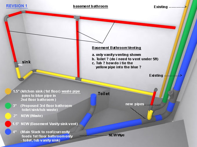

Hi Jimbo Thanks for looking at this for me - please find attached NEW image showing the tub placement with added explanation for orange pipe and basement fixture venting.
the orange pipe was originally tied into the blue pipe.....i have not touched the plumbing as yet - this is more of a plan and info exercise to help me understand a little more abuot venting etc
ps if anyone else would be kind enough to look at this, that would be awesome
thanks
novice plumber
& i will be posting a couple more images re tub placement in around ten mins from now.

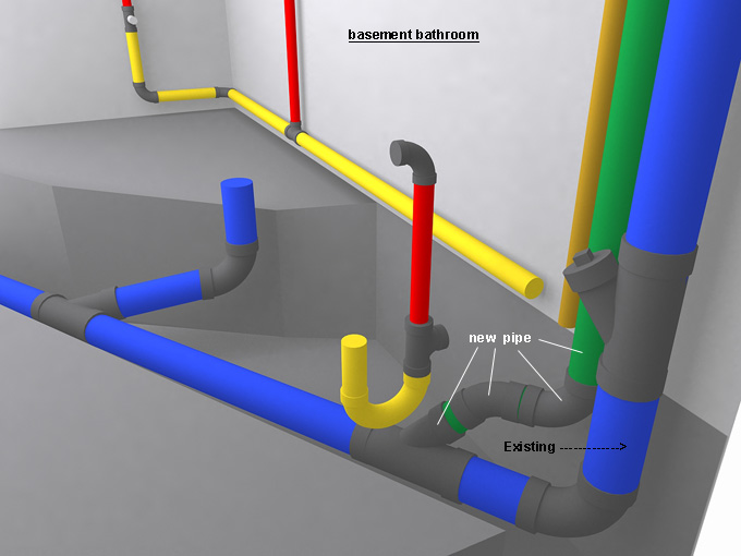

close up of tub pipe, main stack and proposed 3" 3rd floor pipe
im not too sure on the linkage of the green pipe to the blue - I used 4x4x3 wye 45 and 90 elbow (cant seem to find a sweep).... could i just use a 45 from the vertical green pipe and run it straight into the 4x4x3 wye? (this exceeds the pitch of 1/4 per ft or 1/8 per ft)?
still not too sure on how to link the yellow and orange pipe to the blue pipe
thanks for any advice given - greatly appreciated :)

1. The toilet is not vented, and the third floor bathroom will create a big problem for it until it is vented.
2. The overflow for the tub does not connect to the trap's vent.
3. The intermediate vent on the line to the lavatory is doing nothing and is not needed.
4. There are many ways to make the final connections. Which one is "best" will be determined by exactly how much space you have to do it.
