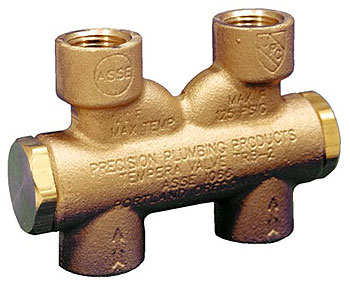

Hi: In our new addition, the building inspector said we need to have "some sort of new fangled" shower valve, so we'll have to rip out the one we put in and replace it. Ok, he didn't say "new fangled", but what he meant was we'll need one that has an anti-scalding device. I've started looking for a new valve, but the trouble with this is that my wife wants a shower with two cross handles, not a single control valve. All I see is single handles. Are there any valves out there with separate hot and cold handles that are to code? Thanks--Marty
