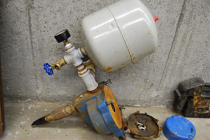

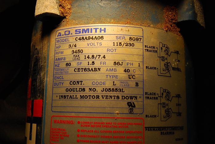

Here is some info about the pump & motor:
A.O. Smith Model C48A94A06, SER 8G97, HP 3/4. Also on the A.O. Smith plate is: Goulds NO. J05853L. The cast iron motor adapter has part#1K310 casted into it.
I have a Goulds Jet+Plus pump that the cast iron motor adapter cracked. (I think my irrigation guy didn't drain it properly before winte:mad:)

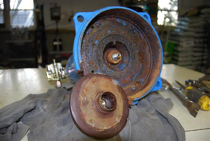

I found the Goulds ITT manual by searching for that part number and want to order one and install it. My problem is that I can't figure out how to get the motor adapter off of the motor shaft. I have found, on this forum thank you, how to remove the impeller, but now I need to remove the spring looking thing that appears to be holding the motor adapter on to the shaft.
My other question is, now that I have the thing apart, are there any other parts I should replace? This motor/pump is pretty old, installed by the previous owner so I have no idea exactly how old it is. It is only used in the spring/summer.
And my last question is, when I am looking at the Goulds ITT manual I assume it is safe to say my model is a J+,right? Under the J+ series heading on the parts listing there are several columuns, J5 J5H J7 J10, J15. How do know which columun to get my part numbers from? I would like to replace the impeller, but there are four different part numbers listed under those five columns.
Thanks in advance for any help anyone could provide me.

That spring can be preyed out with a couple of screw drivers.Unbolt the motor from the pump casing and tap the edges of the pump end. It should pop off. I would replace the shaft seat along with a a new casing gasket and guide vain O ring. The area where the shaft seal sits in should be cleaned thoroughly and the porcelain and rubber should be lubricated with K Y jelly. The seal can be pressed in using a socket as well as the spring. When pressing in the porcelain ring be careful that you press it in evenly so the rubber wont tear.

That pump you have is a J7S, which is a 3/4 hp shallow well jet pump.
The spring thing is a mechanical seal, which is part number 10k10.
The stationary half of the seal is pressed into the motor adapter. It presses in very easily with your fingers.
You'll want to replace the seal ring, which is part 5K6, and the diaphragm, which is part 5K162.
Inspect the impeller (2K60) and guide vane (3K67) and replace them if you see any signs of wear or cracking.

Just wanted to let you folks now I finally got my pump put back together. I found a pump shop clear on the other side of the country that I was able to order all the parts from, $174.00 total. Local pump shop wouldn't sell me the parts, would only do the work for me and charge me nearly what a new pump would cost. Most of the internal parts seemed fine, but I figured while I had it apart I would replace everything else. Put it back together and installed it yesterday and it works fine.
