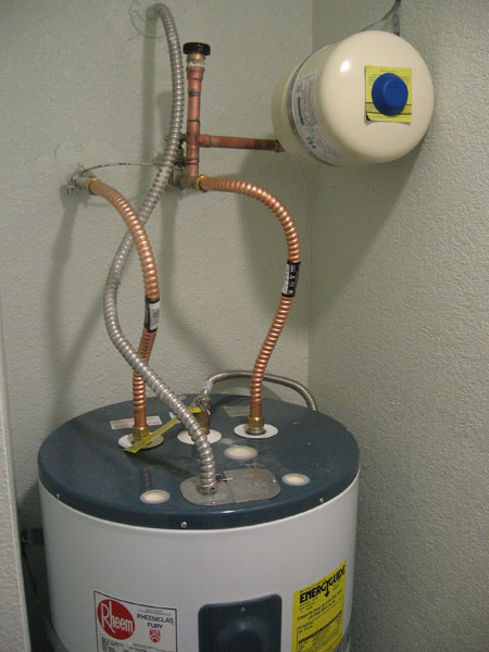

    Here is an electric water heater installed on a foam pad, with expansion tank, and antisiphon valve.

    We lay our expansion tanks on their side, right on the heater. We pipe in a tee a few inches above the cold nipple and screw the tank right into it. Other #2 used often around here is to mount the tank upside down right above the tee and use the bull of the tee to aim towards the back wall, turn up just past the tank, install your valve and pipe to the wall as your normally would.
    Hey Terry, what'd you use for the T&P drain? Almost looks like a flexible gas line? At first I thought it was a s.s. braided line. No reduction in pipe size there is there?
    Stainless steel water heater connector, similar in size to the copper flexes. It's just farther away in the picture.

    quote; Here is an electric water heater installed on a foam pad, with expansion tank, and antisiphon valve.
    AND a corrugated flexible "hose" for the T&P valve which would NEVER be allowed in this area.
