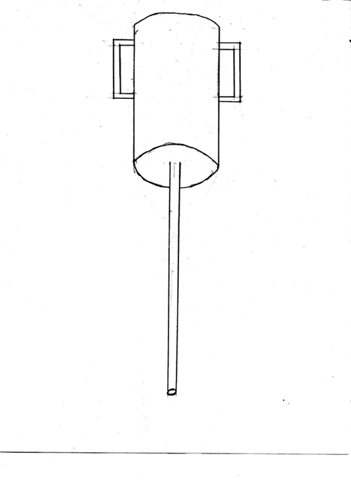

Using a Sledge Hammer is the worst way to drive pipe. You will almost always break couplings and ruin threads.
This is what a hammer should look like.
