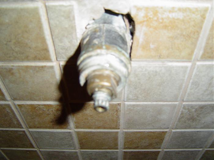

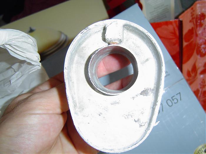

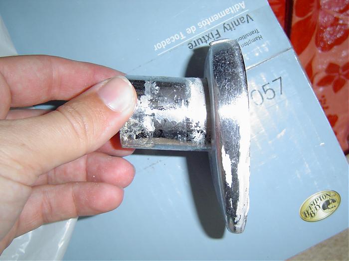

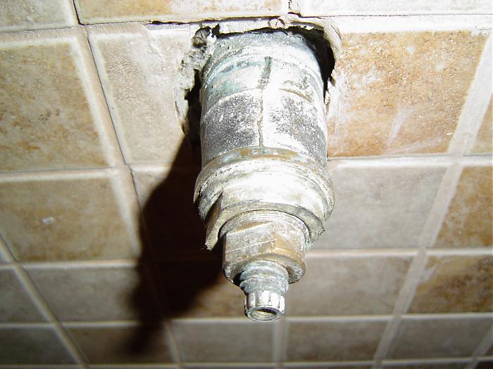

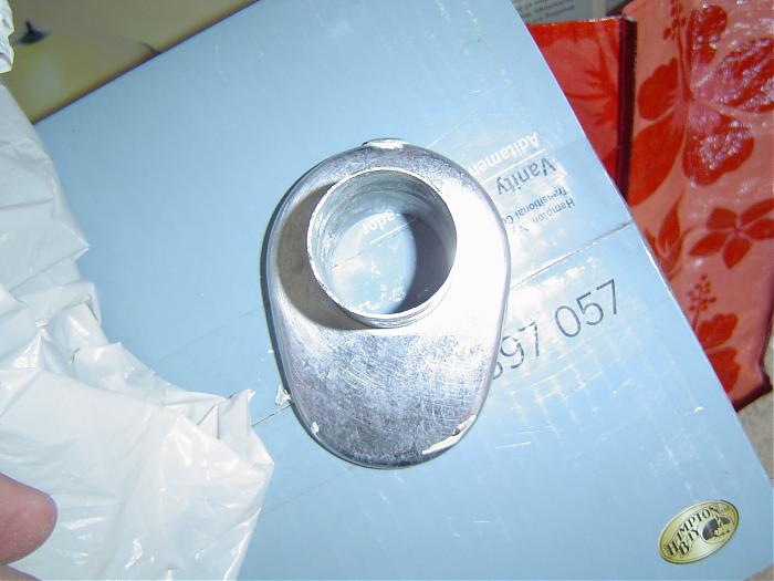

    Does anyone know where I can get a replacement for this wall flange. In the pictures it looks like a one piece, but is actually two: the flange and tube, that are attached with a set screw.
    I don't know the manufacturer or name, just that it's in a condo in Hawaii built circa 1971. I believe it's original. None of the home depot stuff fits the stem.
    Anyone know where I can get a new one? I retiled the shower and it looks pretty good except for this crappy old flange. Thanks.

    thats a Crane . I don't know if the trim or eschuchians are available seperately. You may end trying to fit some generic eschuchians and sleeves .Unlikely you will find anything generic to fit
    23,508
    Default flange
    That oval flange was used for valves which had screwdriver stops below the handles. Call Plumbmaster 1-800-338-1867.If your sleeve is 1 5/16" o.d. then it is their part number 34955 which is the sleeve, flange, and screw. But verify that it is either oval like you have, or the more common round one and if so whether you can use it. It is for a Crane Dial-ese faucet.
