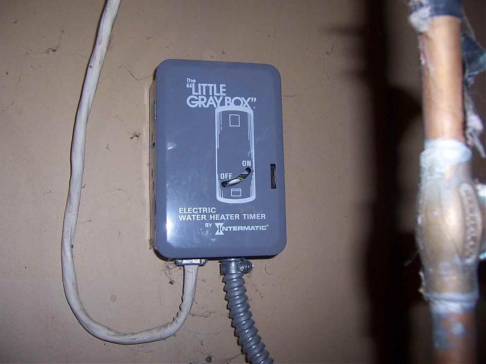

    Default Timer for Water Heater (Pictures)

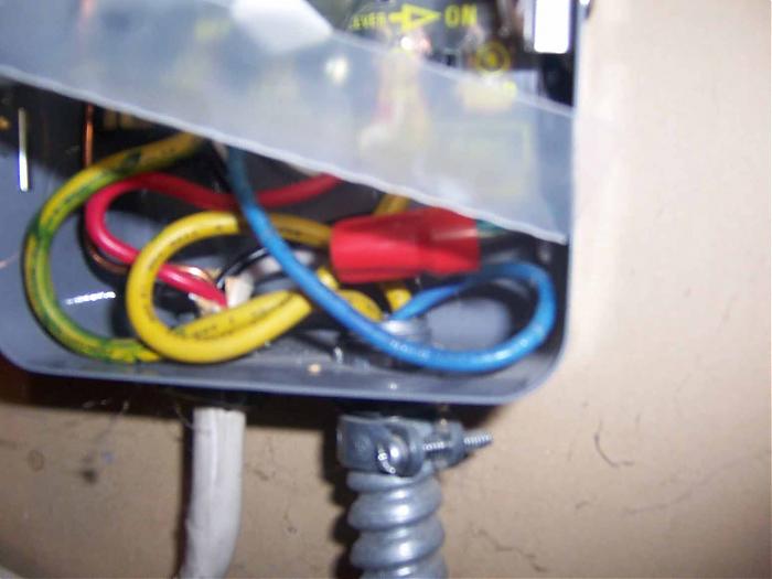

    This Grey Box, is an Intermatic timer for my water heater. I have off-peak metering, but this timer is not wired properly.
    Can someone please tell me the proper wiring for this unit? I've called Intermatic but they were not very helpful as I was on hold for a very long time waiting for a tech. There is 10-3 coming into the box.
    Thanks,
    Molo

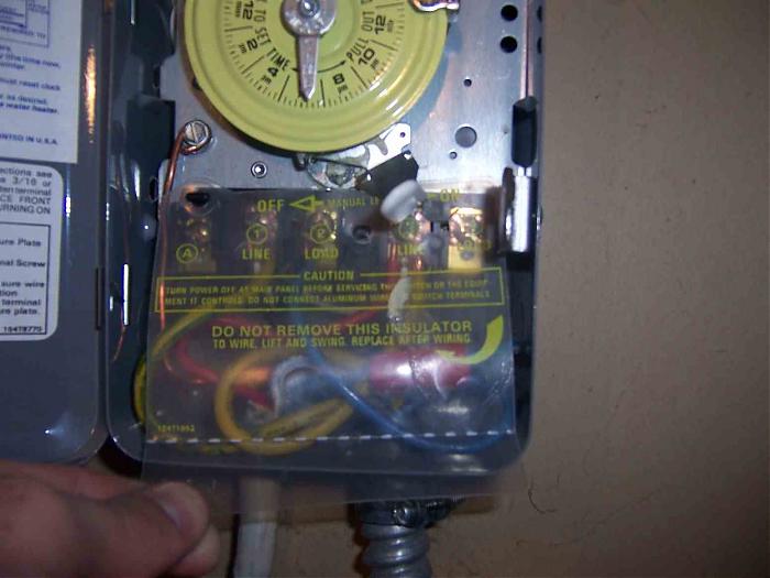

    Licensed Electrical Contractor Speedy Petey's Avatar
    Jun 2007
    NY State, USA
    922
    You're gonna have to remove that plastic shield if you want us to help you.

    Terminals 1 & 3 are the LINE side,(from the panel) 2 & 4 are the LOAD side, they go to the heater... not sure why they ran 10-3, but your not going to be using one of the conductors...

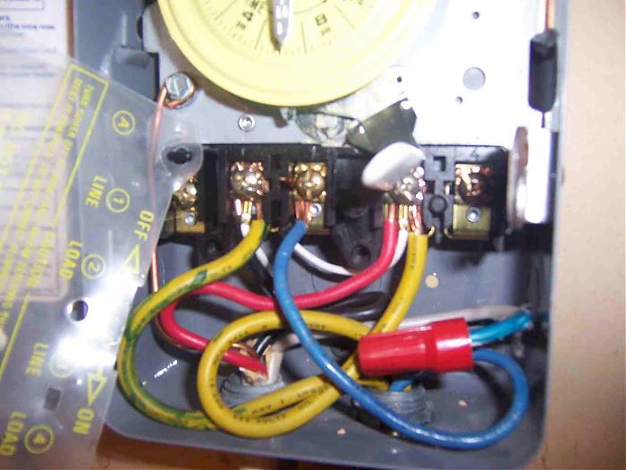

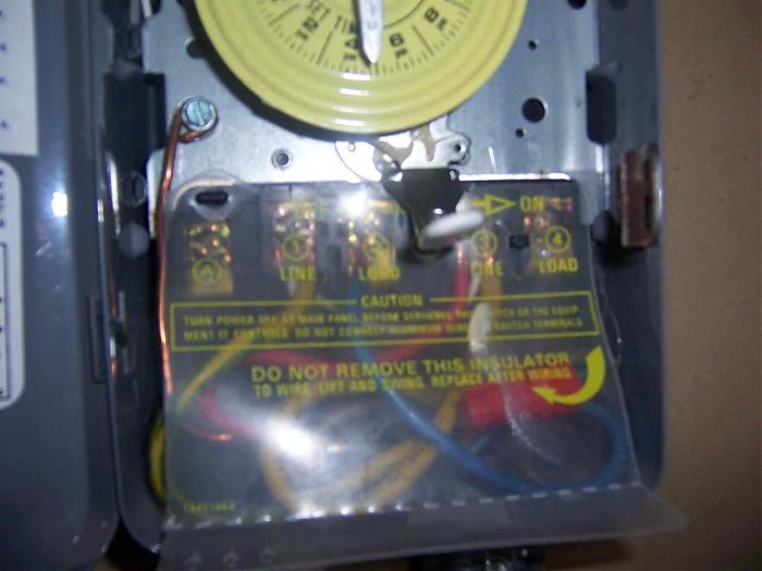

    Default Better Pictures
    Some Better Pics,
    I believe this is a wiring problem, I have set these timers succesfully in the past, and this one continues to come on based on demand, not the timer. I have to use the manual lever if I want it to turn off.

    Electrician Chris75's Avatar
    Aug 2007
    Litchfield, CT
    608
    How is the water heater wired? Is the blue and yellow tied together at the heater? Its obviously wired wrong... just not sure why they ran 3 conductors to the water heater.

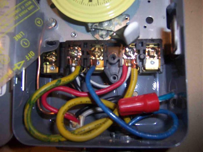

    Default better pic. of inside of timer
    A slightly better pic of the inside of the timer. The water heater doesn't pay attention to the timer. It turns on when there is demand. I've set these timers before with no problem, this is why I believe it may be a wiring problem.
    Jun 2007
    NY State, USA
    922
    I have no idea what that blue is, but both yellows (I assume the load 240v) are on the same terminals as the red and black feed. The switch is doing nothing.
    DIY Senior Member molo's Avatar
    Sep 2006
    cold new york
    825
    As you can see in the first pic. The timer is supplyed by 10-3. The timer then supplys the water heater through the flexible metal conduit.
    The white from the 10-3 is in a wire nut all alone. The Large blue from the armored conduit does not go in the wire nut with the white from the 10-3. (the picture is deceiving)
    Jun 2007
    NY State, USA
    922
    I see that. Can you tell us what the blue does?
    Jun 2007
    NY State, USA
    922
    As stated before, the two yellows need to be on terminals 2 & 4.

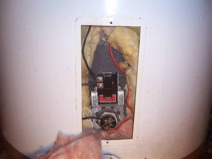

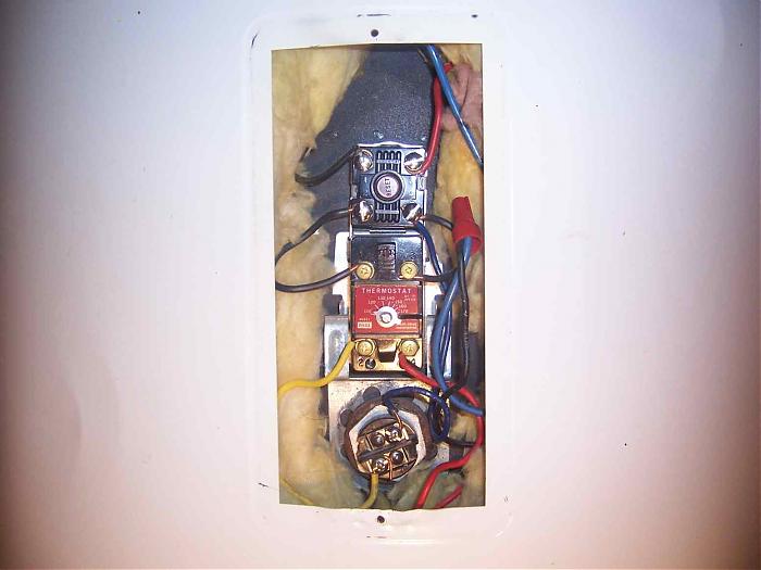

    Default Pics of Upper & Lower Element Wiring
    Pics of Upper & Lower Element Wiring. This is the best way of showing what the blue does.

    19,222
    The two hot leads from the power panel need to go to terminals 1 and 3 (doesn't matter which one goes where). Then, the two leads that go to the WH need to go on terminals 2 and 4. You have no connection on terminal 4. It MIGHT work, since it appears you have one lead connected to the hot line input, but won't work via the automatic switch. What you have is one hot lead connected to the WH all the time; the switch is only switching one lead, not opening both.
    9,003
    http://www.intermatic.com/images/ins...heets/wh40.pdf
    http://waterheating.rheem.com/conten...ofessional.pdf
    You will need the wiring diagram for your water heater. The second link above is for Rheem, and may be instructional. Figure F on page 20 of the manual is how yours likely would be wired. It appears that in this configuration, the upper element is always live, but the lower element is controlled by the timer.
    Can't tell from the pics of your water heater how that switched wire is connected, but it appears your t-stat configuration may not be compatible with timer operation. In any event, find the wiring instructions for your model, and go from there.
    If you have off peak metering, that should be controlled by the off peak meter outside your house, which is under the control of the electric company, not a timer which you can control.
