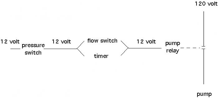

Please have a look to the flow switch link below
http://www.watts.com/pro/_productsFull.asp?pid=685&ref=1
I think kiking in the pump by a timer activated by the pressure switch is a must because if you wait till the flow switch paddel get pushed by the flowing water you must wait till the city pressure is able to flow to the pump inlet and that would not happen at the cut in pressure of the pressure switch if it is greater than the city pressure ( most of the cases it is bigger) otherwise you would open a faucet and wait till the pressure tank empties ALL its water capacity then the pressure is less than the city pressure for the flow switch to kick in .
A second timer would be needed as well to stop cycling at the city pressure near to flow switch pressure threshold
I do agree with you that the Thermal sensor is a bad idea because the pump would be toast before it cuts out
I am thinking of another idea ..
The new pump would be able to deliver 87 PSI sucking from a bucket of water without any need for city pressure just if the water is just present at the pump inlet , so I am thinking of fixing a sensor that would sense the presence of water in stead of the flow switch
Any comments?

There will still be water in the lines, it will just be at 0 pressure. A loss of prime or reverse acting pressure switch would be the simplest. If you give it a wide bandwidth, such as off at 20 and on at 40, it should not bounce the pump as the pressure in the city line increases.

There are lots of solutions; many of which have been suggested here. I suggest that you pick one and implement it.
First you must define your requirements to yourself.
1. What is the lowest source pressure that will be available when the pump is drawing low flow (maybe 3 to 5 GPM) from the system?
2. What is the required pressure range (low at pump start; high at pump shutoff)?
Then, buy and install a pump that provides the GPM and pressure range that you need.
A Goulds HSJ07N will deliver a shutoff pressure exceeding 70 psi at zero psi suction pressure, and it will work even if the suction pressure is 50 psi.
At the "zero pressure suction" condition it will deliver about 15 GPM at 50 psi.
You can set the pressure switch at 50/70 or anything else you like as long as the shutoff pressure is 70 psi or less.
You must have a relief valve set at maybe 75 to 80 psi.
So, all you need is the pump and pressure switch that delivers what you want, and a relief valve to keep from exceeding the safe pressure limit if the pressure switch fails.
If you want even more pressure there are pumps that will deliver what you want.
No relays. No reverse action pressure switches. No worries about varying water pressure as long as it is greater than zero.
If you want it fancier you can get a pump control that will automatically shut things off if the source fails completely.

Thank you BobNH
I have bought already a new 2HP expensive pump that I am going to install to rplace my 1HP pump that i have it running right now that is why I am keen on some sort of a suitable but simple dry run protection
The pump I have can deliver 87 psi at zero city pressure and I will set up my pressure switch to 60/80 so now I got my cut out pressure problem solved
I was thinking of a protection method works on either pressure or flow , from the views given here I think the most simple is the pressure switch reverse action but what I am worried about is that may be my new pump when it starts would make a sudden momentary drop of pressure at the upstream side that would make the low pressure switch opens and ut off the power specially if it is set to a low value like 1 psi for example
any comments?
I am planning to go buy it tomorrow so I would appreciate your comments soon
You said if you like it fancy , there is a pump control , what is that ?
of course I am VERY keen on having that sort of protection because in summer I always have frequent city water cut offs in the peak hours and one of them is enough to burn my new pump
