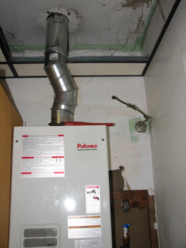

    Talking Redwood ...you make me wonder....
    I wonder in which state they will have their
    first carbon monoxide death due to a poor
    install of one of these heaters....by the home-owner
    if not that ..... then a potential fire.....
    I would almost bet you that someone has already
    cut corners and installed one of these with only
    single wall or double wall galvanized flu pipe
    not wanting to shell out the huge expence of the
    SS flue pipe......
    give that flu pipe a few years of a strong jet blast going through it
    and a house will go up in flames somewhere...
    I am sure that they will blame the experts at Lowes
    for selling them the cheap stuff

    Here ya go Mark:

    What's wrong with that? I sell a bunch of those every week. I sell them everything they need. If the are nembie DIYers I usually sell them a copy of the "Idiots Guide to Plumbing" a torch and some solder too!
