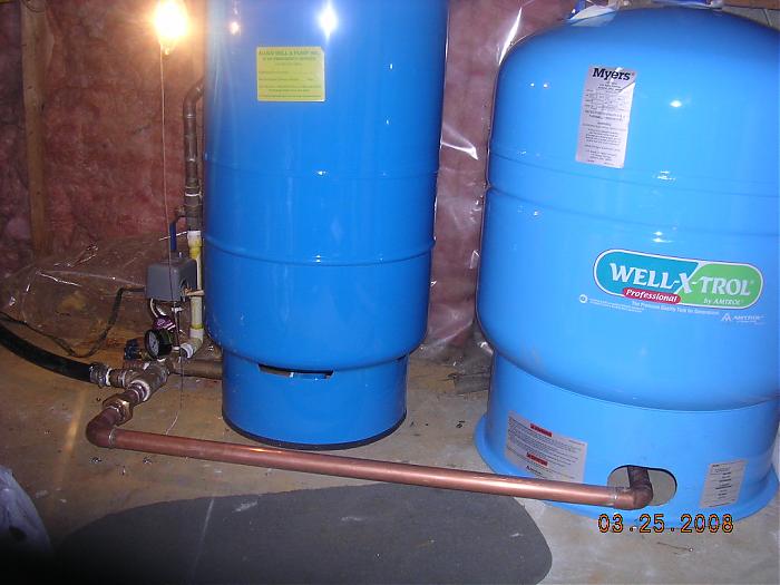

    My question- with the install of the 2nd tank- basically the line comes in and branches off in a t to the two tanks( original tank has the long-cross tank fitting kit with a check valve- pressure switch etc..) the new branch to the new tank is just the pipe branching off - no check valve etc.... would not having a check valve and or pressure switch on the side of the new tank cause the water pressure to drop to zero?
    The new tank is an amtrol wx-205 old- tank is dsi ds20. pump is a myers 4" submersible.

    I'm not sure from the description what the relative locations of the pressure switch and tanks are, but here is what you MUST have.
    1. Both pressure tanks must be connected so there is no check valve that would prevent water from either or both pressure tanks from supplying the system. Both tanks must always have the same pressure because they must be connected without an interfering check valve.
    2. The pressure switch must be installed so that both tanks are connected to the pressure switch without any interfering check valve. There must be no check valve that prevents either tank from pressurizing the pressure switch.
    If conditions 1 and 2 are met the pressure switch, pressure gauge, and both tanks will be at the pressure going into the system. I saw a system with six pressure tanks connected via a manifold arrangement and they worked fine.

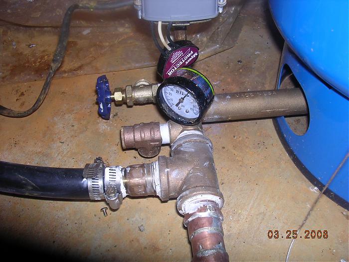

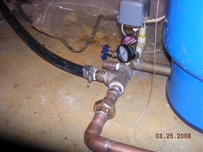

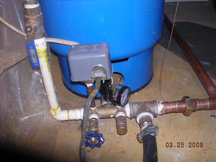

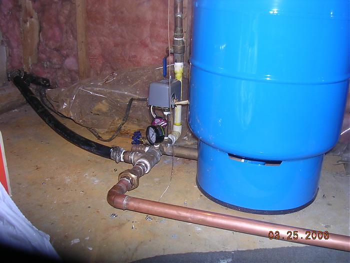

    The line from the well comes in( originally to just the first tank. but now the line comes in and if you are looking at it from behind the line in- to the left after it branches off is the check valve and pressure switch and the original tank- the branch to the right goes to the new tank. here are some photos

    "I went down to the switch and pushed the levers ( Square-D Flotec)"
    This makes me think you have a Low pressure cut-off pressure switch with the little brass lever on the side. If this is the case you probably just have too much air in the pressure tanks. With the pressure switch set at 45/65, you should have no more than 40 PSI air pressure in the tank.
    The pressure switch also need to be located close to one of the pressure tanks. Putting the switch on the tank that has the brass tank cross would be OK. Putting the switch on a tee between the two tanks or anywhere else could cause the low pressure feature to trip out.

    Posted before I saw the pictures which are worth a thousand words. Yes you have a low pressure cut off switch. Probably just have too much air in the pressure tanks.

    Get a normal pressure switch. You don't have a Check Valve there either. At least I don't see one in the picture. Don't worry though, you shouldn't have one there.

    What is that Myers Protector hanging out of the pressure switch doing to the power to the pump? I can't find it when I Google it.
    That could be a time delay that is preventing the pump from starting after a low pressure event. It could be that it, together with the low-pressure cutoff switch, is causing the problem.
    It may be a business proposition that the pump installer put in to ensure service calls. If you don't know why it is there and what it does, then the installer failed you.
    It is a lightning/surge arrester. Came with the warranty.
