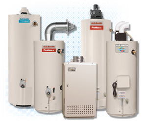

Hi everybody. Just wondering if somebody could help with what I'm guessing might be a fairly simple question. The pilot light has been going out fairly regularly on my water heater (A.O. Smith, ProMax). I get it to light right back up again, but it's annoying nonetheless.
Anyhow, a notice on the water heater tells me that the "air intake screen" should be cleaned every six months. I'm not sure, but I'm wondering if this might be related to the pilot light going out on my water heater. Problem is, I have no idea where the air intake screen is to clean it.
Would anyone out there possibly know? Any help would be much appreciated. If there's another theory as to why the pilot light keeps going out, I'd sure appreciate hearing that, too.

You may see it outside of the house with a rodent gaurd on it. The same place the exhaust is going out. Which one does it look like?

Thanks. I think it's the second from the left.

The air intake will be on the heater its self if it is a standard vent heater and not a power vent, sounds like it is if the vent is on the roof.
Look and see if there is a plastic screen below the burner area near the floor, if yes remove it and the air intake is in there.

AIR INTAKE SCREEN ON sMITH HEATERS
I agree with REDWOOD...thay are real close to a whhirlpool
if it is a newer than o3 heater ....they are talking about
the air intake screen under the heater.............
look at this pic...
you need an air compressor and an air hose to blow out the lint
you need to blow it out from underneath the unit and from inslde the chamber
look at the dirt and scale that falls down on that inner air screen.....
and this heater is only 1 year old..
Smiths are bascally a pretty crappy heater all in all..
they have about the same stupid design as the shitty whirlpool---
but they do use a better gas valve and thermo couplings.
IHMO ..the better quality parts are the only
reason they have not had a law suit fiasco like whirlpool
you could try to blow all this out if you wish, I have done that before
but finally found that after all the work ....it usually still boils down to a
defective gas valve and or thermocoupling.....

The second from the left heater looks like it is a sealed combustion chamber with a co-axial intake/exhaust pipe going to the exterior. But, if so, it would normally have an electronic ignition system.
