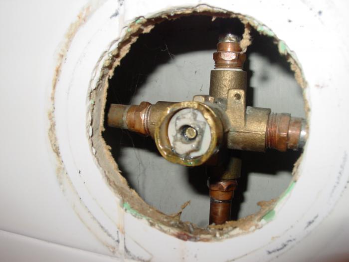

    Hi there. In this economy, we are renting our former primary residence. Was in the middle of turning the home and noticed the tub fauce in one bathroom wasn't working. Upon investigation, the supply was off. When I turned it on, I saw why: the faucet was leaking. So I turned the water back off, pulled the handle, plate and goodies to get down to the cartridge. At that point, I swore extensively. The renter tried to fix this themselves. They wrenched on the plastic part of the cartridge and it is quite chewed. They also (and this is the great part) snapped the stem off. Yes, I know. The home is 100+ years old. No access to replace the valve without cutting into priceless subway tile which is not only on the surround of the tub, but the walls and the floors. Which basically means, I cannot cut into the tile, enlarge the access and replace the valve.
    Is there anyway to get the stem and cartridge out of there? I have been searching around and have seen a potential solution of taping the cartridge and inserting a 1/2 bolt to try and get the cartridge out.

    Generic advice is good! Does have anti-scald. Really do not want to replace the valve. Did I mention that? Got it to spin a bit after using wd-40.
    Looked around in the crawl space and found the part of the stem they broke sitting on a ledge. No markings for who made it.
    Pic attached.

    There are a lot of horror stories about people having trouble removing the cartridge from those valves. In it's current state, I'm not sure any of the pullers designed for this will work. Maybe Dremmel tool and some judicious cutting. Or, maybe drilling and tapping the center, then using a bolt threaded in there. See what the pros have to say.
    I'm leaning toward drilling/tapping and bolting. I can grab the lip of the plastic and apply enough force to wiggle left/right and then try to pull. It isn't budging when I pull. If I wanted to put the clip in, I could. It isn't moving out at all. I'm afraid to keep pulling as I will just rip the pipes out (which of course aren't blocked in and secured tight.
    I am thinking after letting it sit overnight with some more wd40 and then adding some leverage with the bolt, I may be able to work it out of there.

    those can be extra , extra mean to get out....
    I have written up the instrustions here before....
    what you have is going to have to be drilled out
    without getting into the brass on the sides...
    if you can get a nice pair of vice grips to grab that
    brass stem, you might be able to pull it out with
    leverage..
    make a series of drill holes through the plastic then
    MELT IT OUT....
    get a screwdriver you dont liek anymore and heat it up with a propane torch till the tip is bright red, then slice through the plastic like butter
    eventually you will win..
    have fun

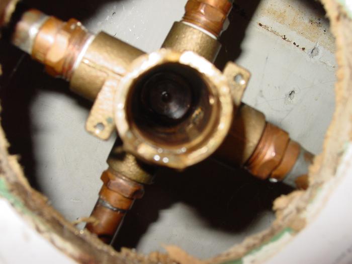

    Starting drilling into the stem. I gradually increased drill bits until I got to one about as big as the stem. Suddenly the stem started spinning on with the drill. I switched to low speed and gentle started pulling and.... the MF'er is out! I am envisioning that is what labor is like but will refrain from making that comparison to my wife.
    The plastic is all black and there is a ton of crap on it. So it's going to have to be replaced. Wheat do I replace it with? Something which does not present a repeat of this fun experience would be great!!
    I stopped at HD this morning and their replacement catalog is based on length. I can't really determine that because the stem is broke off.
    Well, upon further inspection, there is rubber sticking out of the hot and cold sides of the valve. Does this mean my valve is shot? I am not sure if the gskets came from the cartridge or inside the valve (pardon my ignorance).

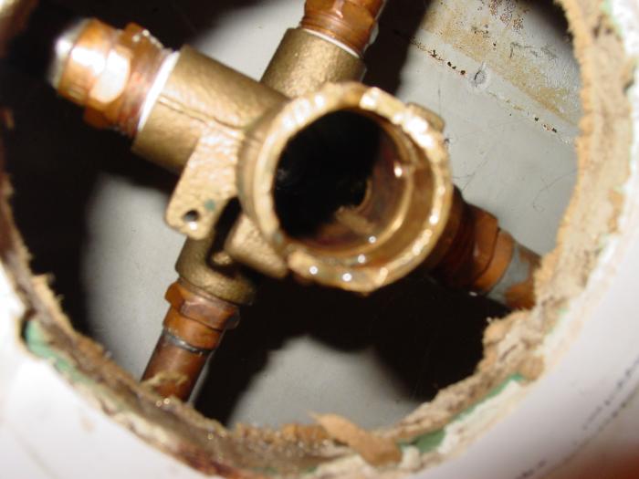

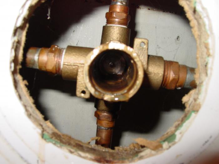

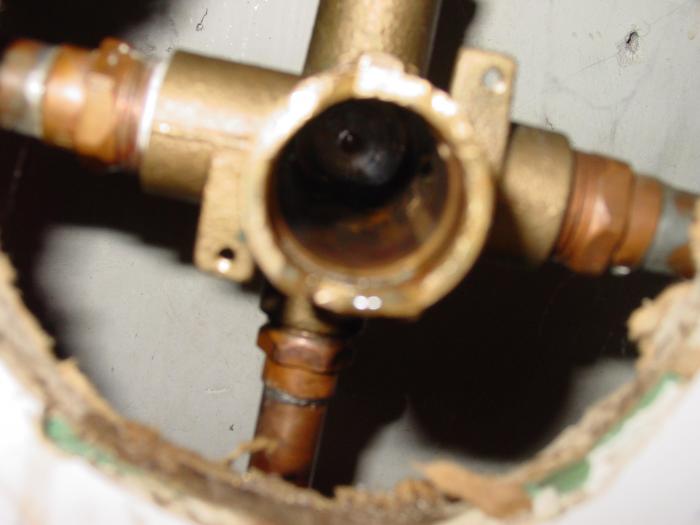

    Also, I knicked the side of the inside of the valve with a drill bit when I was trying to dig out the plastic. I know. Not smart. There is about a 1 inch gouge in the inside of the valve. Does that mean it's shot??
    Got the rubber gasket out. Flushed the valve. Here are some pictures of the gouge...
    Not the best pics, but the best I could do.

    With those gouges looks like you'll be replacing the valve...

    Talking needle nose pliers
    you got to get intothe faucet and get out all that
    beat up rubber that is stuck inside it....
    I have had it actually crammed up into both the hot and cold inlets of that cam....
    if you clean out all the crap then maybe turn in on and blow it out with water pressure you will probably win
