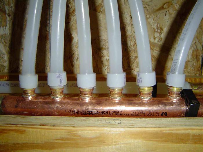

    Default UPDATE with pics
    Ok. They had another guy they work with sometimes come over. He couldn't figure it out either. He ultimately concluded, by looking, that they had nicked the brass nipples when cutting off the capped pieces. This guy went and got new manifolds--no charge to me. They reconnected all the existing and new lines and turned the water back on. No leaks. That's the good news.
    Here's the bad...maybe. I was looking at the connections they made, and some of them don't look so great. When I researched the Wirsbo website, they basically said the connections have to be snug up against the rim of the fitting. Some of them are, but on a couple, there are some gaps. On one run there are two couplings where one should have sufficed. I suspect it is because when the other guy got the new manifolds, he got an extra slot so the line they were going to "T" off of is now connected directly. Still, just one more unecessary joint IMO.
    In some cases, it looks like the pipe wasn't cut perfectly square. Like I said, no leaks as of now, but are some of these connections begging for trouble? If so, how do you get someone to fix something that isn't leaking? They claim if it's not leaking now, it won't barring some equipment failure. These guys have been good to work with so far, but am I making a big deal out of nothing re: these connections? Thanks. Your technical answers will help if I need them to come back.
    By the way. Thanks to Master Plumber Mark. So far, you've been spot on in your assessment on the problem I've been having. Thanks.
    Dec 2007
    7,460
    I don't like that last connection on the right side of the manifold! the tube needs to be on there with less stress. They probably cut it too short or the talon clamp needs moving.

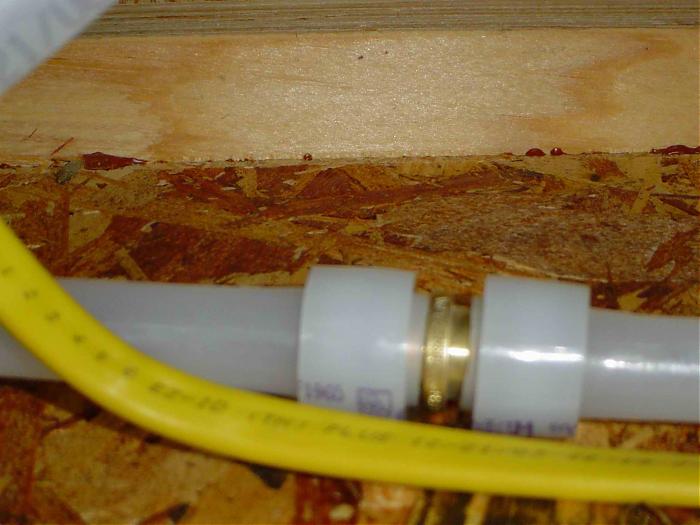

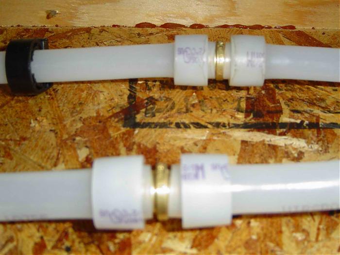

    the only fitting on the manifold that I would accept would be the one on the far left. The collar should extend over the end of the tube, not slid back. All the other connections show the collar slid back. If these "installers" had taken Wirsbo's classes they would probably know how to properly use the product. When expanding, the ring should not slide back, if it does, it should be re-done. Usually the ring slides because of water or some other substance on the tube.

    that looks pretty crappy....they have not used the stuff before..........
    it would probably be best to just to re-do it all.....
    becareful not to scar up the mainfolds if you are goun to re-use them
    the idea is to keep it clean and cut it square...... ane the outer ring should overlap the
    inner ring by just a "blonde hair" if you know what I mean.....
    they have done those ass backwards and I am surprised
    that more are not leaking....
    these are the best pics I got of some past stuff this winter with the hair dryer
    in a nasty cellar.....,,,,,
    click on the first pic....
    you should be able to see in this first pic on some half inch elbows the
    outer ring is over lapping the innner pipe that " special blonde hair"
    and that makes all the difference.... please ignore the rest of this hell hole.....
