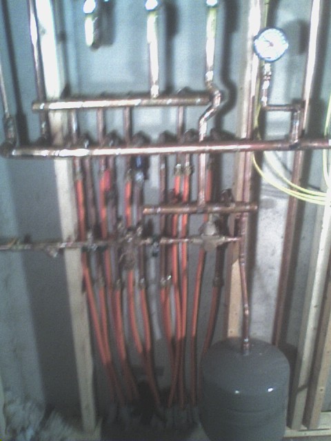

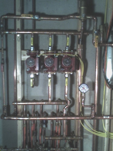

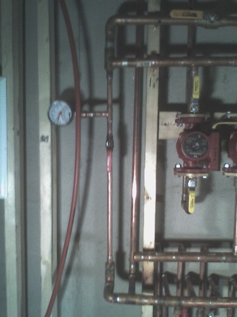

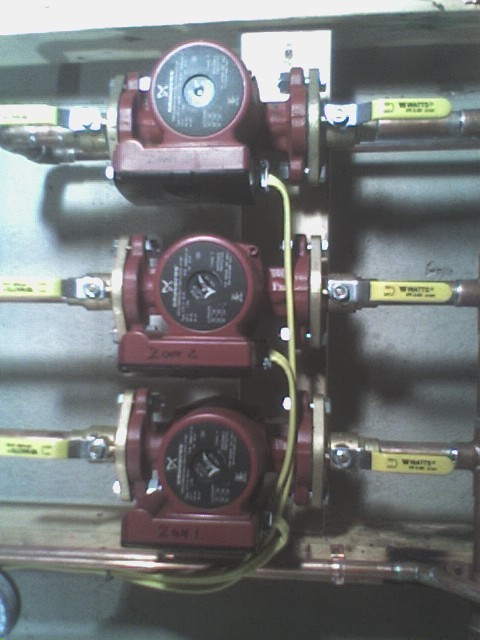

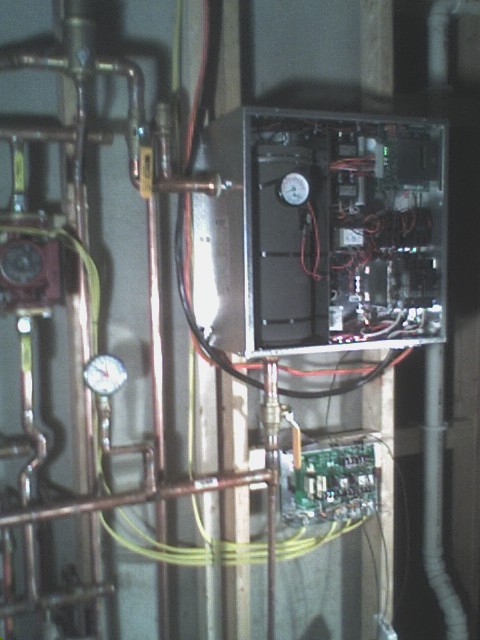

    DIY Member enosez's Avatar
    Jan 2007
    Long Island NY
    81
    Are you using a tempering valve setup?
    If so, I found out that the pumps need to go after the valve as they are very restrictive and create a lot of head pressure before the valve.
    Also, are you using a by-pass? With the tempering valve, and having the pumps before the valve, I've seen a lot of the flow "bypass" the manifold completely. (Assumming you have a bypass)
    I've even seen the temp gauge on the manifold read 120 supply and 90 return, yet the actual flow and temp of each zone was no where near that. That was due to the temp valve and bypass being pipe right into the manifold.
    Maybe a picture of your setup would help the proffessional see your set up and gtuide you.
    Good luck and keep us posted.
    ok I'll take some pics, no tempering valve, yes to bypass, but only I installed bypass after I seen the system was not working properly.
    A square foot will always be a square foot, weather its in the basement or on main floor. For my calculation the basement is 1940sf the main floor is also 1940sf. I'm not trying to heat the main floor though just the 1940sf of the basement. And yes there is no insul in ceiling of main floor, so I know I'm not goinig to be able to retain the heat the floor produces, but I would think that it would still heat up.
    Location: Iowa; temps have been in the high teens and lower, this week we are breaking 20 into the 30s even then back down to the 20s later this week.
    I did started the floor system 2 weeks ago when we were in the single digits.
    here are some pics of the setup
