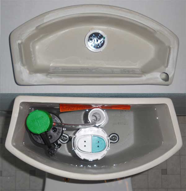

  5. #35
    14,201
    Nobody buys them, that's why.
    The tank goes on just like the Aquia. I've installed one Persuade in the Seattle area, and guess what? No leak.
    And I've sold 300 Aquia toilets. And guess what? I had a few that other people installed that leaked, that I was able to fix by retightening the bolts in the tank.
    If a homeowner has no problems installing them, then you would think a plumber could do it too.
    But hey, since we're one for one on the persuade, go ahead. They are both dual flush toilets, they both use a floor mounting system, and they both use a similar method for attaching the tank.
    You may be over thinking this.
    The biggest difference is the flush between the two, but then checking that, that seems pretty close too.
    The bowl on the Persuade that needs a 12" rough at the minimum, no floor mold, and the supply can't be behind the bowl.
    No floor mold. What were they thinking? Why not have someone park a car six inches away from your drivers door too?
    Looking inside the Persuade tank.
    Looking inside the Aquia tank. Wow! what a big difference.
    Does one tank look harder to install? Not to me.
    The supply line for the Kohler is a bit strange though going through a hole in the side of the bowl.
    The location of the water shutoff for the Kohler has less margin for error.

    Hi, all. Thank you for the informative thread you have going here.
    I'm having an issue and it's making me want to tear my hair out! I have a Kohler Persuade on all three floors of my 2-year-old house. My upstairs Persuade has developed a slow leak into the bowl, and I can't figure out why. My first guess was the middle flapper (?) mechanism with the dual-flush system, so I swapped it with my middle floor Persuade to see if that would fix it, and it doesn't! I don't know what else can be causing the water to slowly leak into the bowl from the tank.
    I've left this toilet turned off now, because of it (tank level drops an inch maybe every 10 minutes).
    Please, I'm at my wits' end!

    Default Did you figure it out?
    Quote Originally Posted by WilliamG View Post
    I have the same problem and need to figure his out. I noticed that the rubber gasket attached to the bottom of the flushing mechanism has developed bubbles in it, like blisters and I think this is preventing a complete seal. I haven't been able to remove this gasket from the flushing assembly. Do I need to buy a new entire mechanism instead of just replacing this gasket?
    By the way, as others have mentioned, this toilet was a royal pain in the butt to install. I am not a pro plumber, but I know my way around toilets and this was just bad design and execution. Like others have mentioned, the supply line going into the side was odd and the plastic grommet snaps into the opening never has fit correctly. I would never buy this toilet again.
