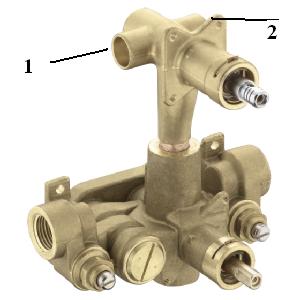

Does anybody know which diverter handle position on this valve controls which outflow port?
When the handle is straight up and down, I'd like to have the wall showerhead on. When I turn the diverter handle, I want the overhead shower to go on.
Is the up/down position on the diverter handle outflow port 1 or 2 in the photo?
Thanks.

If I understand your question correctly, It shouldn't matter which is which. As you may know or not know, the moen cartridges are reversable at 180 degree stem rotation. You can adjust it to suite your particular application

AH-HA!!! i didn't know that the valves were reversible. that answers that! thank you very much.
