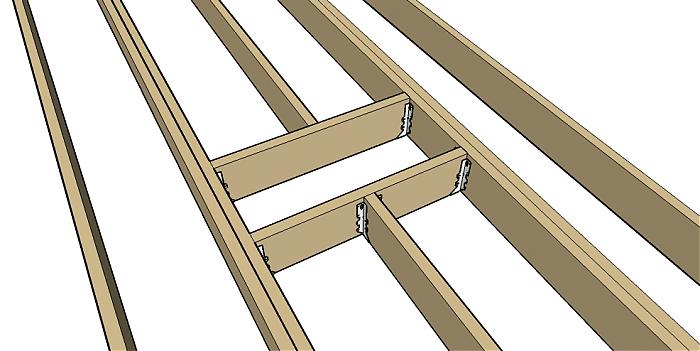

As the friendly neighbourhood carpenter, I just want to remind you that notching is only allowed if you're close-ish to one end of the joist. No notches in the middle 3rd of the joist's span.
Also, in terms of how big your notch can be: no deeper than 1/6th the depth of the joist.
If that's not enough room for the fitting... you have two choices:
1 - redesign your layout so that the tub doesn't line up with a joist
2 do this:
EDIT: if your joists are supported, within 3' away, you can do the 1st drawing. But if their support is more than 3' away, you're stuck doing the doubled-up joists on each side, like the 2nd drawing.

Frenchie, wouldn't you want to double up those 2x's on either side of the cut joist?
Jason
Frenchie
Jack of all trades
1,239
36
If it was a wide hole - cutting more than one joist - then yes, you'd have to sister the joists on either side, along their entire length; and also double up the headers (the 2x running at 90 degrees, that the cut joist hangs from).
For a small hole like this, only one joist cut out, singles are fine.

AZ Contractor
89
Phoenix, AZ
I beg to differ.
You're adding 1.5 times the load on each joist adjacent to the cut joist when you cut that 'center' joist. I'm pretty sure the floor joists are rated to carry loads up to their max and sized accordingly.
By cutting that 'center' joist you're more likely than not exceeding the max load on the adjacent joists.
I would sister another joist to them.
How much does a tub full of water weigh?
Add that to the max load on those joists and you're probably looking for trouble.

Nate R
473
Milwaukee, WI
I beg to differ.
Maybe I'm wrong, but my line of thinking agrees w/ AZ.
Cast Iron tub is what, 300 lbs? And many tubs can hold 35 gals of water w/ no one in them, correct? 20 gals of water is about 167 lbs. Add a 200 lb person and you're looking at 667 lbs total over those 3 joists for the tub.
Also, assuming the tub is 2.5 X 5, you're looking at over 53lbs/PSF

Hmm... I'm actually reconsidering, now. When I posted, I was trying to remember @ what point you start having to double up the trimmer. My code book wasn't handy, I just recall being told not to bother, a few times in my life, framing openings for toilets and/or chimneys... but then framing's not my main thing, not by a long shot. Did a quick google, found the diagram attached below.
On the other hand, when I look in my code book - because it is handy right now - this is what I find:
R502.10 Framing of openings. Openings in floor framing shall be framed with a header and trimmer joists. When the header joist span does not exceed 4 feet, the header joist may be a single member the same size as the floor joist.
so far so good...
Single trimmer joists may be used to carry a single header joist that is located within 3 feet of the trimmer joist bearing.
uh-oh...
So it looks like y'all are right - my earlier comments & advice are only true in very specific instances, when it's near the end of the joist span.
POST SKIMMERS, PLEASE NOTE:
THIS DRAWING IS WRONG ABOUT ALLOWING SINGLE TRIMMERS FOR HEADER SPANS UNDER 32". POSTED FOR EXPLANATORY REASONS, ONLY.
Assuming 16"oc, the opening is less than 32"...more like 30.5" or so...sistering the outside wouldn't hurt.
Yeah, what I thought - but if you read my post, with the code excerpt - that illustration is wrong.
You can only use single trimmers if the opening is less than 3' away from the end of the joist span.
