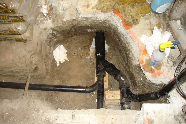

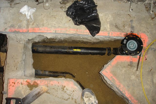

    Smile Inspector says: “The toilet-vent must be upstream of the toilet.”
    I can’t figure out what he wants me to change.
    I plumbed in a toilet flange with no san-tee. I used a 2” wet-vent through the sink drain. I think I did my plumbing correct. I think I just need to explain the plumbing concept to him.
    What should I tell him?

    is a wet vent allowed in your area?
    Brent
    Feb 2005
    4,244
    Talking looks ok for our area
    the toilet looks to be vented in to the
    2 incl line going up off the 2x3 why which
    should be some sort of wet vent......
    unless that line is serviceing the washing machine
    that should be considered a wet vent.. for the toilet
    it dont have to be upstream here
    25,673
    Default vent
    The vent connection has to be downstream from the fixture's trap, which your's seems to be if we are seeing it properly.

    is there a 45 dgr fitting goeing up rite after the vent ?if so the trap arm is higher than your vent.

    Quote Originally Posted by plumb4fun View Post
    No,
    The trap arm only drops 1/4" per foot

    No flat venting allowed. It gets blocked with sewerage [You don't know it] and
    You end up with No vent. See if He will allow a low heel 90 and vent up into the wall behind the toilet.
    Quote Originally Posted by toolaholic View Post
    exactly, you need to roll the wye up at a 45 degree angle so the vent will be above center grade.

    Quote Originally Posted by Garrett View Post
    That is what I have.
    I did not create any flat vent.
    By the way, I read that flat vents can be used for toilets if done properly.

    Toilet's vented, but where's your end of line clean out?
    14,209
    Like SR Denny mentioned, you have rolled the combo at a 45, for the lav that is wet venting the toilet.
    If you had an end of the line cleanout, that would be all he could ask for.
    That could be done by rolling a 3" combo, a 3" 45, then a 3" cleanout tee, with a fitting reducer on the top for the lav above and vent above.
    But not vented? As long as the inspector allows wet vents, that's what it is.

    I could extend the drain and add another vent up stream of the toilet.
    sewer...................v...............WC........ .......v

    Went into the city to meet with the inspector. As soon as he saw me, He said: "the plumbing was already approved" and he had intended to stop by to sign the card. I did not ask any further questions.
    Problem solved.
