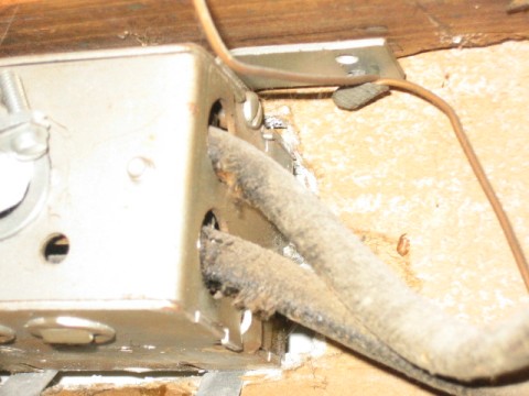

I'm doing some work in my attic to upgrade insulation. I'm pulling up the existing insulation as I go to ensure that there are no problems. I'm coming across alot of old knob and tube wiring, alot of which has been disconnected, and new wiring has been run all over. There are a few places where the wiring disappears down through the ceiling. I'm guessing that these wires are no longer live, but I want to be sure before I add new insulation. What's the best / easiest way to test these old wire to ensure they have been disconnected? I plan on removing any old wiring I find to leave no doubt for the next guy that owns this 80 year old ramshackle. Can I trust a non-contact voltage detector?

So, I was all excited to get up in the attic and do my insulating before I came across this K&N wiring. I tested the wires (blacka and white) with a non-contact testor and the tester is lit up like a christmas tree on all of the wiring. I thought that it would all be dead since someone ran new wiring all over in the past. Needless to say, I'm completely limp. Since many of the wires disappear into the floor, I'm not sure how to proceed.

If you've got new wiring, odds are you've got a relatively modern service entrance panel, with circuit breakers. With you in the attic, and your lovely assistant (you do have a lovely assistant, don't you?) at the panel, have her turn off the circuit breakers one at a time until your K&T circuit goes dead. Repeat for all K&T segments you can find. That will identify the circuit(s) that are associaed with the K&T wiring. Then it's a matter of tracing each of the "bad" circuits to see where the K&T segment(s) are.
It'd be nice to say "then replace them", but if they weren't all replaced when the new wiring went in, there was probably a reason. If it was just because the previous owner or electrician was lazy or ran out of money, you're OK, since you're ambitious and flush. If replacing the K&T is going to involve some serious demoliton, that's another story.
Having said that, another alternative is to just go ahead and add the new insulation, perhaps posting a sign in the attic to warn future attic-crawlers of the danger hidden under the insulation. Be sure to use non-conductive insulation, but I can't think of any that is (conductive), offhand.

She's lovely alright. Thanks for the advice. Is it possible to mistake a wire being dead by having a switch turned off somewhere, or will it typically be energized always? Also, I just went around and tested every receptacle in the house and they all have grounds. Am I correct in thinking that all of these have been re-wired and the live knob and tube is probably being energized by a light or from a switch?

You're close. The wire must be energized, but current need not flow, for the non-contact gizmo to say "live" on the ungrounded conductor (black, aka "hot"). I'm not sure if the gizmo will ever say the grounded conductor (white, aka "neutral") is live even if current is flowing, but I'm sure someone else knows. I think not, but will experiment today. I think you're probably right, that they elected to rewire the receptacles, but skipped the lighting. Which wires are hot depends on how the lights and switches are wired.

She's lovely alright. Thanks for the advice. Is it possible to mistake a wire being dead by having a switch turned off somewhere?
Yes.
If the switch is off, the wire from the switch to the light will seem dead; it'll only show up as live if the switch is turned on.
Ditto the neutrals on a receptacle with nothing plugged in, or the neutrals from a light that's turned off or doesn't have a bulb in it.
I wouldn't take it for granted. Someone may have run a separate ground wire. I've never dealt with k&t, but I have seen this in houses with cloth-wrapped 2-wire cable, where someone had obviously added the ground wire, later.
