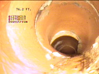

    I&C Engineer (mostly WWTP) Lakee911's Avatar
    Aug 2005
    Columbus, OH
    1,329
    Attached is a view of my sewer lateral looking up from the city's 8" sewer in the street. It looks like there is another offset in the clay pipe one joint from the lateral. I'm assuming it's a a 3 foot section of clay pipe and that it's 6" diameter. It's located under the street.
    My sewer is 4" cast iron and I've only been able to camera about 70-75 feet from the house. This ties in around 90-something feet, so I've not seen some of the pipe between the two.
    A friend of mine is locating my permit circa 1923 to see what else it has on it. I know this 8" sewer is 8 feet below grade. After I collect some more information I can do some measuring to find out the depth of mine line from the house to the street.
    Jason
    Nov 2005
    Central Florida
    2,504
    I like the backhoe idea. Bite the bullet and do it right.
