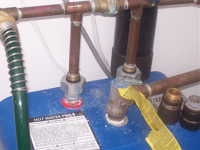

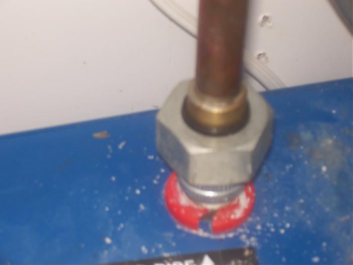

I installed a new electric 50 gal Richmond water heater over the weekend. The new heater had installed already these blue plastic lined nipples on both the hot and cold. I pre-sweated copper female adapters to the copper pipe and then attached the female adapters to the male nipples. After doing such, I've read that there could be a problem with corrosion taking copper directly to the steel nipple. I did not use dielectric fittings because these corroded so badly in my last water heater....(I had to change them mid-way through the life span of the previous heater). We have extremely hard water here in Indianapolis and I don't have a softener. So, getting to the question...Am I OK as is because the nipples were plastic lined or should I replace with other fittings? Any help anyone could provide would be greatly appreciated!

Did you attach the copper fittings to the nipples before you soldered? If so, you may have done some damage.
As to the direct hookup of copper - what do your local codes say? Here, we have to use a dielectric or waterflex.
do (did) you have a bonding wire connecting the copper inlet and outlet of your old water heater?? #6 stranded copper with appropriate brass clamps in our jurisdiction. the dielectric union(ala rugged) will outlast the tank - unless the flux isn't cleaned off.
just FYI, if there is no bonding wire, and dielectric unions are attached, there will be an electrical potential (difference) between the pipes which the water will carry, removing material from one side, and depositing it on the other. if there are no fittings, then the metal of the tank acts as the bonding. in wihch case you get the classic galvanic reaction between dissimilar metals.

I always use unions in addition to the nipples, I never make a copper to galvanized connection.
It does not matter if it is a dielectric nipple; that first course of thread on the nipple is in contact with water AND copper and that's where the galvanic reaction starts from day one.
That's why they leak after a short period of time that's why when I remove 3/4" FIP's from the water heater for scrap on an old water heater they literally snap off......taking 3-4 coarses of threads on the nipple.

Male dielectric unions are horrible and I don't recommend their use unless you sleeve them with a partial dip tube.
The use of dielectrics are designed to break the continuity of electricity flow by providing a separation between dissimilar metals. This path of electricity is low grade and can cause premature failure of the tank by its presence. I'm discussing a gray area where my knowledge starts to fade when dealing with electric, I might be relaying the information incorrectly but I'm close I'm sure.
A discussion usually spawns off the topic of whether dielectrics work or not because the water itself serves a conductor of sorts.

Yes, I sweated everything that would be close to the nipples before I attached the female adapter fitting to the nipples, I am confident there was no problems from that. I am just concerned that now I should have used a dielectric union between the copper and the galvanized nipple...even though it was plastic lined.
Should I be OK if that is on there for a week more before I rework it all with the dielectric unions?
As long as you didn't apply heat to the nipples, since they are plastic inside.
A couple of weeks won't be likely to cause any problems.
