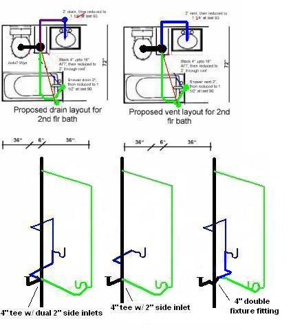

Below is the proposed layout for my 2nd flr bth.
The questions are:
1 -Can the toilet be attached to the shower drain with a 4x4x2 wye and then connect to the stack for venting? Is this method of venting the toilet adequete?(NOTE: the shower is vented above)
2 - Can the toilet closet bend be 4"..or is 3" the preferred size? (NOTE: the stack is 4"). Toilet is/will be an American Standard.
3 - Can the 4" stack be reduced to 2" AFTER connection to the toilet via a 4" T?[EDIT: Spoke to friend; informed this is illegal]
Venting for shower is at appx. 96" AFF, for sink 44" AFF. There will also be a 2" cross(2x2x2x2) attached at 60" AFF to allow for venting to fixtures below (on 1st flr).

The left hand one will not work, and there are many different ways of piping the right hand one. It depends on the space available as to which ways would be best.

The left is drainage only, the right is venting only.
What is NFG about the drains?

Is this any better?
Revised drainage plan:
- Toilet vent is now attached to sink venting
- Shower drains over into 4x4x4x2 SaniTee (on 2")
other SaniTee attachments:
- over to toilet - 4"
- down to street connections/1st floor drains - 4"
- up through roof - 4"
Will this work now?

Note: I'm not a plumber, so make sure to get a second opinion on this from HJ for example.
Since the toilet is right next to the stack, I don't think you need to vent it. If you were to use a 3" toilet drain, you'd have to vent it if it were at least 6 feet away from the stack {UPC}, but you're using a 4" which means you could be as far away as 10 feet without venting it {UPC}.
Likewise for the sink: maximum trap arm distances for a 2" pipe are 5 feet {UPC} and 8 feet [IRC]. From the drawing it looks like you may be close enough to run the sink drain without a vent. You will need a P-trap for your sink drain.
- Erik

My "proposed" vent stack:
34353%3C3523232%7Ffp45%3Dot%3E2345%3D%3A88%3D666%3DXROQDF%3E23237%3A8%3B593%3B%3Aot1lsi
The stack is 4" for the entire run, extending a minimum of 12" after the roof (not ceiling) line.
All drains are 2" minimum - last fitting possible will be reduced to make the need; ie sink at 1 1/4".
Like wise all vents are 2" minimum.

I dont know if side inlet or dual side inlet sanitary tees can be used in your area, but here is a few different ways to do it. Maybe one of the other guys may know which ones would be allowed or elaborate on a better way to do it.
Good luck on your project...

TonyBagadonutz said:
You shouldn't need to move the bathtub. The tub drain can offset around to the end of the tub, or to install it such as in the last diagram in my post it will already be at or near the end of the tub and is similar to your diagram here.
I do not believe you can use a cross but rather a double fixture fitting (slightly shorter pattern of a wye and 1/8 bend). If your lavatory drain exceeds the maximum distance allowed from the vent then you could install it as in my last diagram and revent it and then there will be no wet venting. If wet venting is not a problem in your area you can leave it how it is and just revent it there.

I was confused (no one is surprised) by your graffiti on my drawing ...I "thought" the green lines were an indication that the pipe would be routed UNDER the tub location.
I am thinking the double fixture fitting is the key here.
Considering the proximity of the toilet to the stack (maybe 20" center to center)...would wet venting be allowed? Getting a vent from the toilet to the stack(or a vent pipe on the stack) may be a challange considering the tight quarters. The toilets are not vented now - but that was installed 20+ years ago and codes change.
Clayton
123
www.facebook.com
I think your last layout is good with changing the cross for a double fixture fitting and eliminate the seperate vent on the toilet.
yes I did have the drain drawn going under the tub, but you could route it around to the end of the tub instead of under it. But I would say to forget my diagram and go with yours after changing the cross. If your code does not allow the sink to drain into the vent of the toilet (4"- without having the seperate toilet vent), I would think it would be easier to connect the sink drain into the tub drain under the floor than to try and add a seperate toilet vent.
Thats my 2 cents... Hope HJ or the other guys can give you some better or definite info.

I would say the one on the right.
UPC codes only allows 135 degrees of bend on a trap arm,
That middle drawing shows two 90 bends. That adds up to 180 degrees.

Depending on what is existing and the amount of leeway in the installation, I would run the 4" stack, (3" might be adequate, again depending on the rest of the plumbing), up behind the lavatory with a side inlet sanitary tee for the tub drain, the tee rotated to line up with the toilet opening, and a separate tee into the "vent" for the lavatory. This would eliminate the bends in the lavatory arm and also any separate tub vent.
