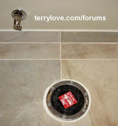

    I've been searching for installation instructions for the Guinevere and Soiree toilet and can't find any. Are they similar to the those for the Carlyle series (MS904114 or MS884114 series)?
    Before I order the Guinevere I want to make sure that my water supply line will work with the wide skirt or if I will have to have it moved over by a plumber. Looking at the specs, which was all I could find, it looks like I might have to have the water line moved since it indicates the line should be 8" from the center of the toilet. How close can the supply line actually be?
    Also, I noticed a "special note" on the Toto website for the Carlyle, which said "Water supply rough-in is wider than standard 5 1/2" rough-in. Consult your builder or contractor." Does anyone know if this also applies to the Guinevere? It wasn't mentioned but it seems that complete information re: the Guinevere is lacking.

    The Soiree and the Guinerver need 5-1/2" center to center or more for the shutoff.
    The Toto spec does not show what you can get by with, it shows a generic measurement that would work on any toilet.
    Terry Love
    14,201
    The Gunivere and the Soiree work with a water supply 5-1/2" to the left.
    The installation is very much like the Carlyle installation. (The Carlyle needs 7")
    You install the Unifit to the flange, and drop the bowl over it.
    If it's a new installation, there may be a plug for the flange.
    Knock out the flange
    Ready to drill the floor and set the Unifit with a wax seal.
    Installed and ready to be caulked at the floor.

    The unifit to flange connection requires a wax ring seal which Terry's excellent picture does not show.
