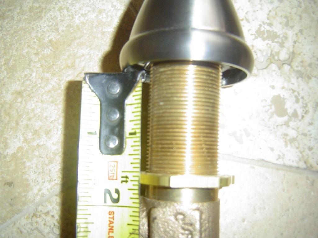

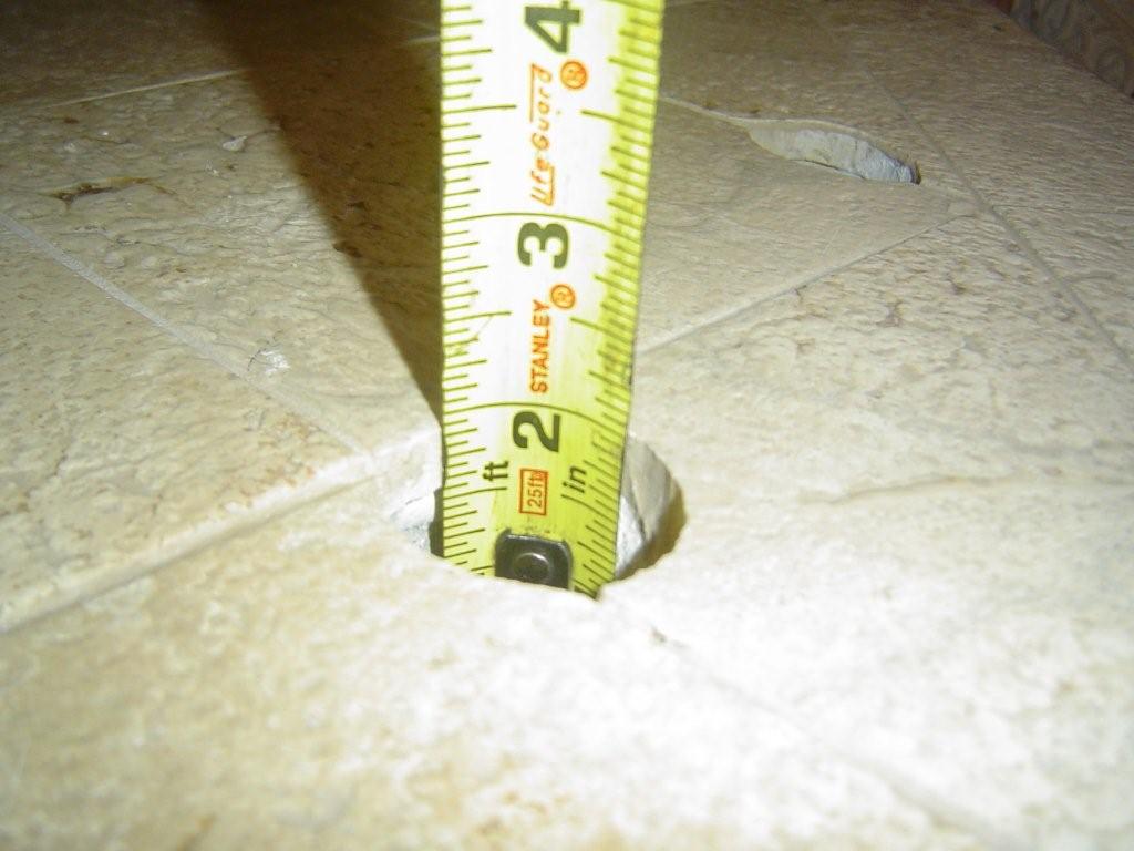

    The top where you going to place faucet &underside where faucet connects
    Thickness of what you are setting faucet on .
    Quote Originally Posted by cwhyu2 View Post
    Name:  deck height.jpg
    thoughts????

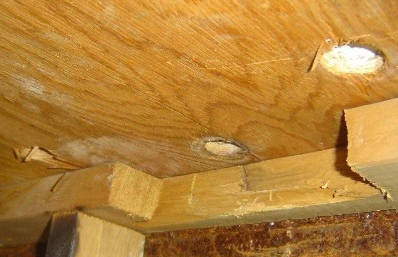

    I ran across this problem once before and had to remove some wood from
    underneith in order to get the faucet shaft to tighten.Can you show underside
    photo from the underside... looks to me like 1/2" plywood didn't measure it though.
    sorry about the resolution .. I had to resize in a hurry

    Is it still 2" I dont what to tell you other than make it fit.You have a choice
    take titile out or more wood.I know there is a soulution to your problem
    just dont what yet. Sorry about typos.
    DIY Senior Member construct30's Avatar
    Jun 2007
    NorthWest PA
    590
    I've had to buy stainless plate with rounded edges, make hole in deck big enough attach plate to ceremic and drill holes for faucet. Home made base plate, some faucets come with them. I don't know if you could buy one ready made. I have a guy that makes them when I need them. He welds studs to the bottom and cuts the holes for the faucet. I don't need screws you can see that way to attach it.
    If you had durarock underlayment you could just remove the plywood from underneath, but I don't think that will work with mudbed. You could try.
    Hope that makes since.
